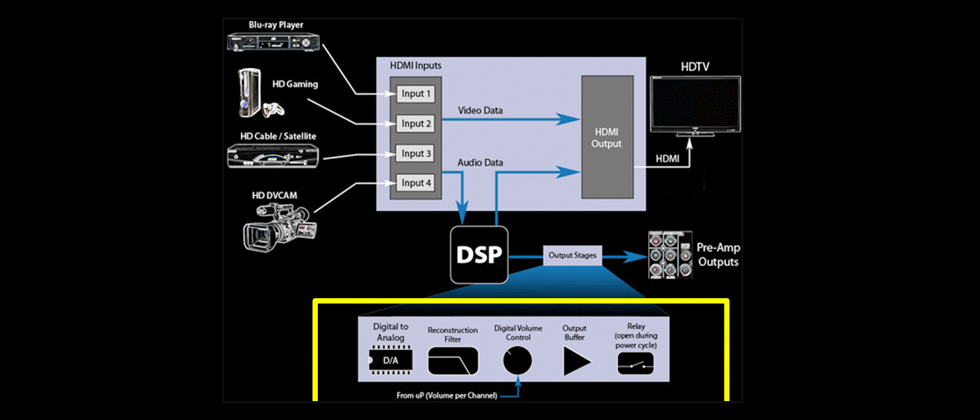

If you are interested in learning more about the technical/objective side, Hometheaterhifi.com has a 5 parts article on AVR builds, highly recommended. I don't believe everything on that article are 100% correct as some of those were not completely unbiased, but I would say most of it are well based on facts.
Below is the link to Part I of the five part article I mentioned earlier, about AVR/AVP builds:

My comments were about the possibilities that the HDAM buffer stage, being right at the end of the pre out signal path, may actually result in higher distortions overall, based on the HTFI review comments, and at least one ASR member who seems knowledgeable in amplifier design. Aside from that, as an EE myself, I do understand the logic that a well design buffer is not an EQ. In this case it doesn't even amplify because the gain is "1", so all it does is to affect the output impedance and/or allowing the pre out to clip at higher output level. All these things are measurable, yet measurements so far did not show better results. One thing for sure, an extra stage must result in higher THD+N because there is no such thing as perfect/ideal amplifier, buffer or not, not even the best available op amp IC, let alone a discrete opamp that the HDAM basically is. So while I was only quoting others, I do believe they are right, as it is logical that an extra buffer stage would add distortions and noise of it's own. The only question is, what benefits it would bring, and that's the part that I looked for supporting evidence, and found none so far. Now the HDAMs circuitry and applications used in Marantz integrated amps are quite different so the resulting benefits could be different too.
Below is just one reference on the HDAM (specific to AVRs/AVPs only)related topic:
In the paragraph just before the "Conclusions" heading, the author commented:
"Harmonic distortion has not improved from the AV8802 to the AV8805 as was expected from the new chips. The change in the worst-case THD specification between the chips used in the AV8802 and AV8805 points to a 50% distortion reduction. We know the distortion is not from the AKM AK4490 DAC since the THD increased as we changed the output level from 2VRMS to 4VRMS with the volume control.
It is possible the HDAM discrete circuits past the new analog ICs are the dominant distortion source. The only way to find out is to open up the case and start probing internal boards which is not something we do here at Secrets."
