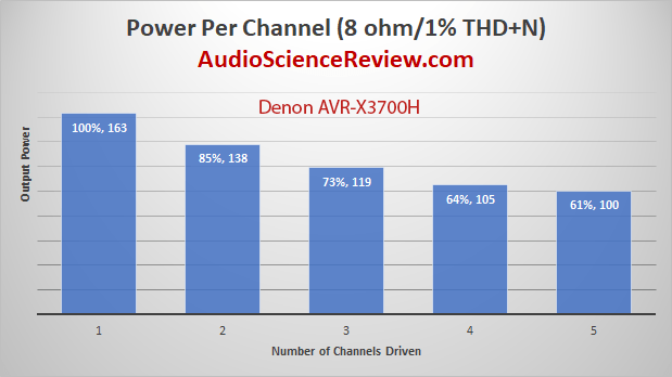

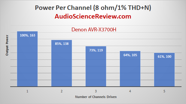

Take into account the following. The maximum capacity of the denon is 710W and at say 70% efficiency . . .thats about 500W across 9 channels which equates to just over 50W per channel . . . . all channels driven.
That's false assumptions on the "maximum capacity part"! Denon has never said the 710 W (for the AVR-X4700H) was maximum capacity whatever that meant. All they said in the manual was "Power consumption: 710 W", there was no mentioning of under what conditions. And if yours is the X3700H, the power consumption is not 710 W, but 660 W.
Also, it would be rare for 9 channels to peak at the same time so any output rating for more than 5 channel driven at the same time is totally academic, bench tests such as S&V's did it as a guideline just to give people some idea of the amp's limit, but is of very little practical meaning. They told you that in their "how we test: audio" article.

Your 70% efficiency assumption would be close, but I think it would be closer to 75% at rated output, and much lower at lower output level.
That's just one example to show you why you shouldn't do your calculation the way you did. That 710 W may be meaningful if you use it to compare Denon and Marantz own models, and even then the comparison would be meaningful in relative terms only. For example, the AVR-X3700H's power consumption spec is 660 W, the X4700H is 710 W, so it may be a reasonable assumption that the X4700H would be about (710-660)/660 or 7.6% more powerful. That's just a very rough estimate obviously. In practice, you need 2 times the output to gain just 3 dB SPL, if you are to add an external amp, you should aim for one rated 200/300 W, 8/4 ohms minimum, for the increase in power reserve to be meaningful.
If you plan on replacing your speakers with some that are more difficult to drive, why not wait until you have decided on your final choice, before considering a power amp.
If you really want to get one now, between the two you mentioned, I would suggest you stay away from the Rotel 1582 MKII and go with the Cambridge Audio Azur 851W that has better specs and its gain is much more compatible with the Denon AVR's pre outs. You would still need something for the center channel.
By the way, the bench test results of the AVR-X3700H will tell you much more about its actual output than the vague and confusing power consumption specs.
