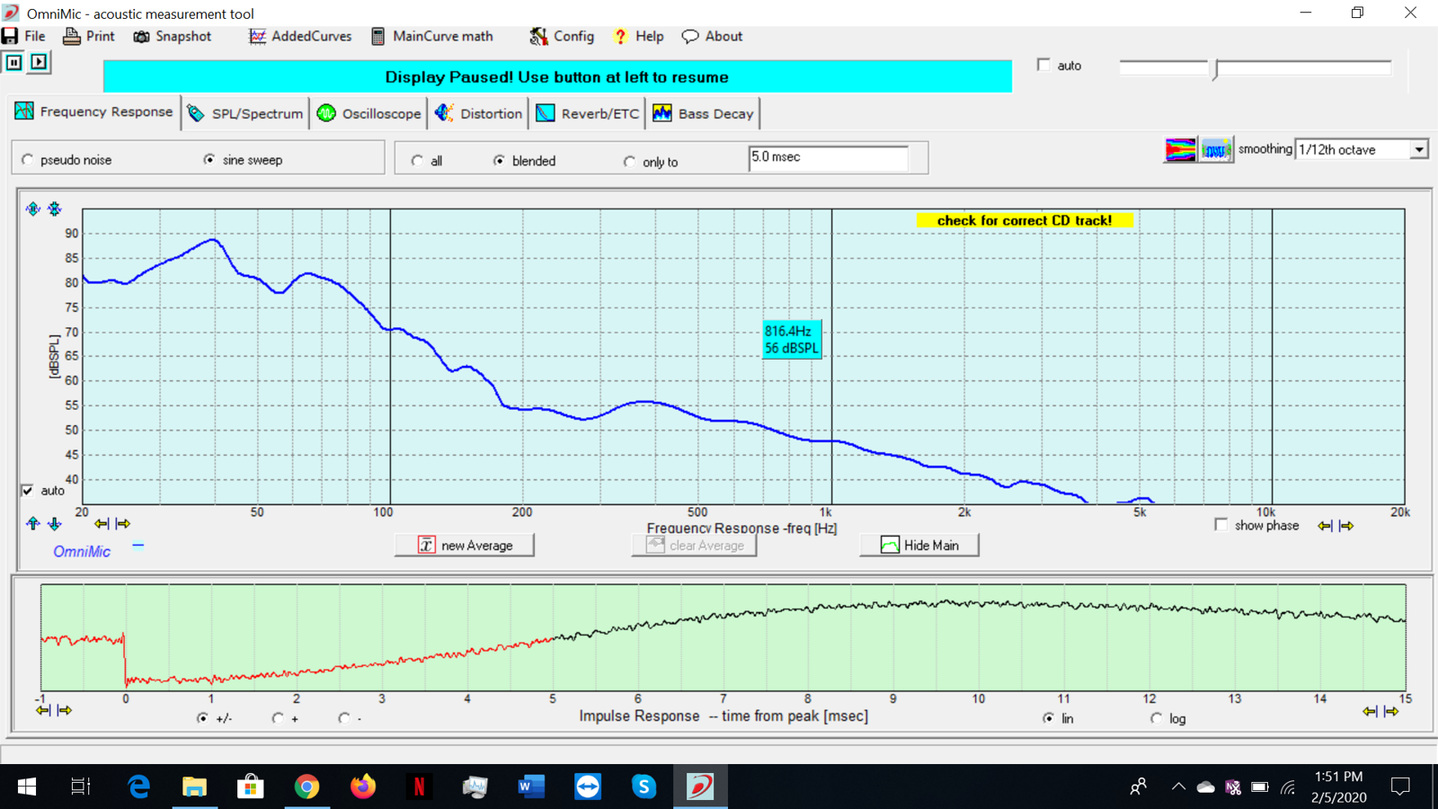

I would not touch that sub with a barge pole. There is NO specification other than it is a 10" sub. I highly doubt it is actually a sub. The subs you have, have an F3 of 32 Hz, so really only classify as bass modules.
That sub in the attachment just about qualifies as a sub as F3 is 27.4 Hz. Most 10" subs do make it under a sub classification. It so happens that 10" driver has ideal T/S parameters for TL loading. This is the result I measured.
Low pass at 80 Hz.
Low pass at 80 Hz.
Low pass at 80 Hz.
