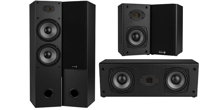

The original Dayton Audio B652 has achieved something of a cult classic among speaker aficionados due to its extraordinarily low price. They were perhaps the least expensive, full-size bookshelf speaker that could be had in its day manufactured by a well-respected speaker component company. It was followed up by the 'B652-Air' to greater acclaim featuring an AMT tweeter. Now Dayton Audio has expanded on the 'Air' series with the release of a tower speaker, smaller bookshelf speaker, and center speaker. What kind of system can be had from the lowest-priced speaker set available to use AMT tweeters?
Read: Dayton Audio Breaks Price Barrier with AMT Tweeter “Air” Loudspeaker Series
Do you own any of these speakers or plan on buying them to mod?
Please share your experiences in this thread.

Personally I am curious about the 4" woofer version, the B452-Air. That might avoid any potential breakup issues that the larger cone could have, and less cabinet surface means less resonance. Not too mention the $32/pair price tag. Yeah it won't have much bass, but no big deal for a system using multiple subs. Hopefully, I will get a pair to measure later on.
