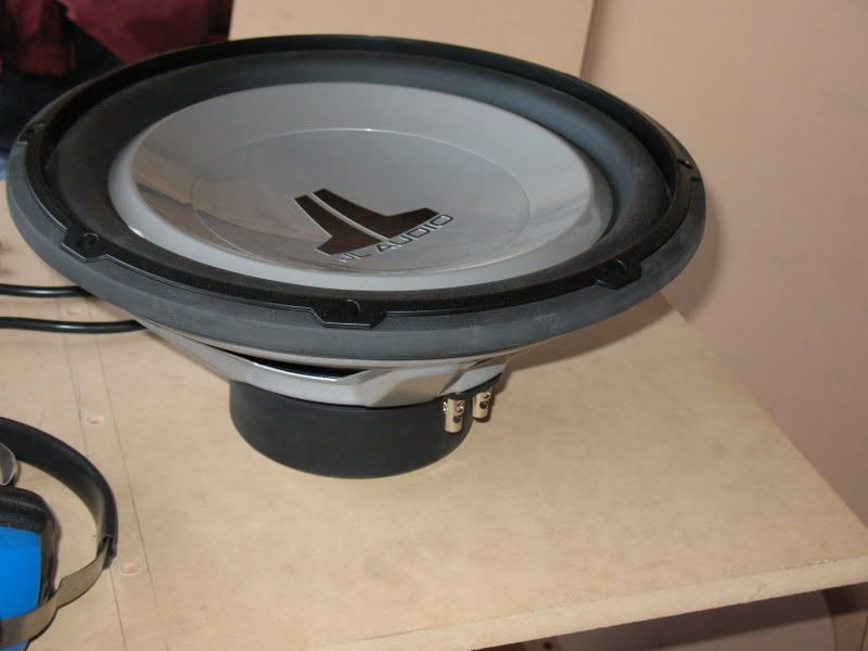

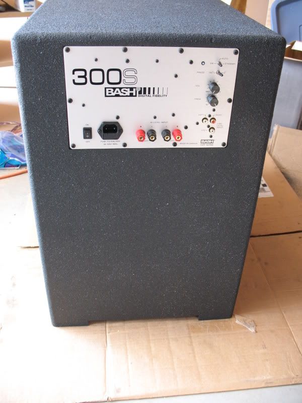

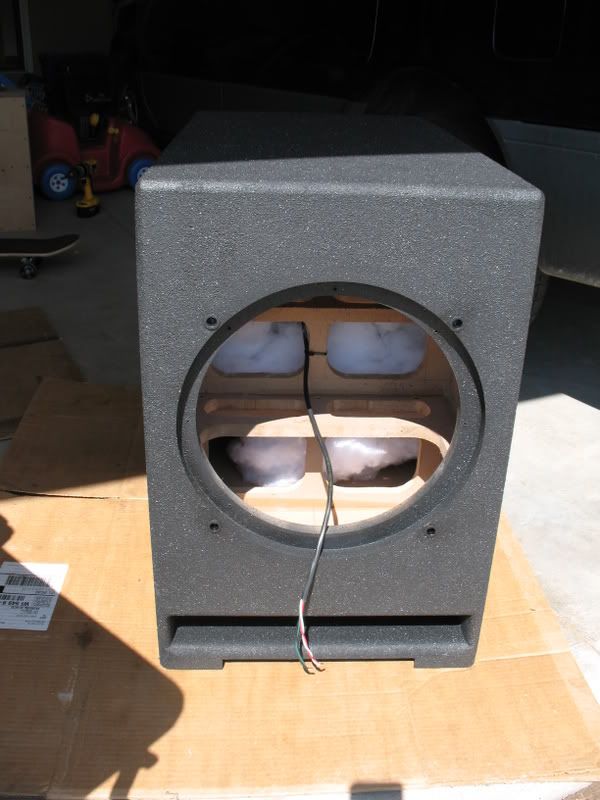

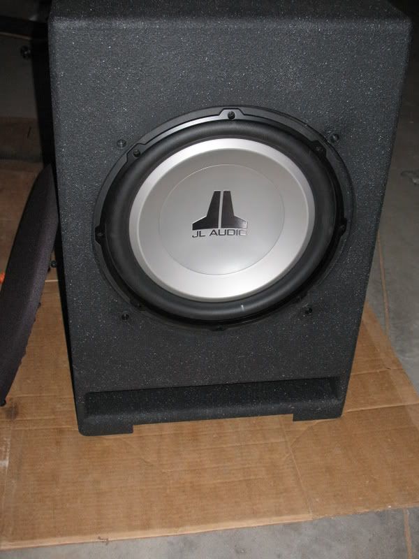

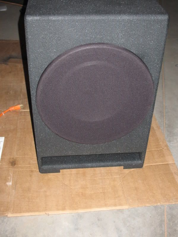

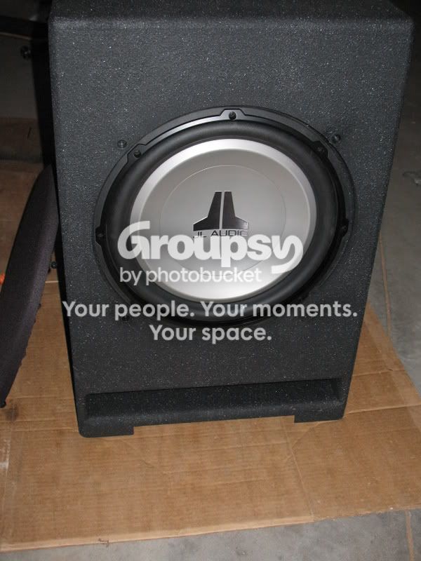

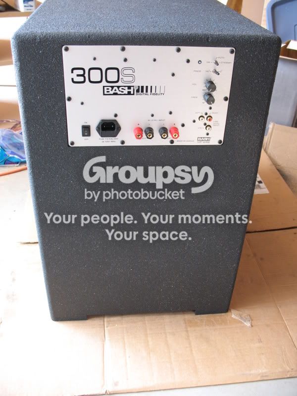

So I did a test run with the amplifier and sub tonight in the enclosure. I did a ground plane measurement at 3 feet from the woofer cone. I was out in the open at minimum 25-30 feet from any large objects.
I used a RadioShack Analog SPL meter for testing with C weighting and slow response. I was just starting to get a touch of audible noise at 20hz, however it is just below the tuning frequency of 21hz. Most of the noise was due to the amplifier reaching a bit past it's limit I am sure.
20hz - 100db corrected actual 107.5db
22hz - 104db corrected actual 109db
25hz - 106db corrected actual 111db
30hz - 110db corrected actual 113db
35hz - 110.5db corrected actual approx. 113db
I did not test any higher in the frequency range so I did not begin to get complaints due to the high output. It did sound very smooth when I ran a quick sweep through it.
This thing is going to be a monster once it is in lbolt's home!!!
