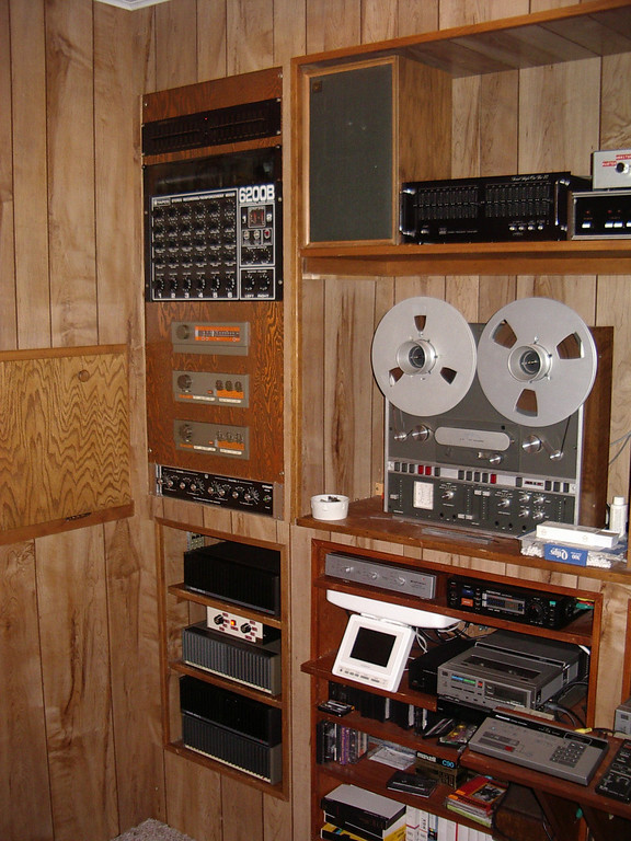

You can see it here. It is the one above the Revox A 700 with the chrome handles.
