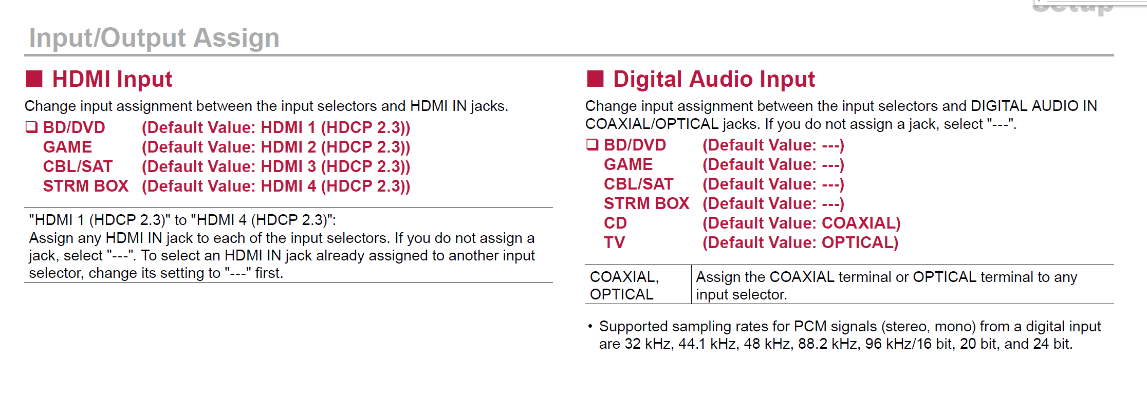

I bought and received yesterday a S.M.S.L SU-1 DAC, but I can't get it to work in my setup, between a Sony BDP-S6500 Blu Ray Player and a Pioneer VSX-935 Receiver. As the DAC only has one type of output, analog, it must be connected to the receiver's analog input (RCA). The Blu Ray player, in turn, is connected to the DAC via digital input (coaxial cable).
What happens is that the receiver simply does not recognize the DAC; In fact, it does not recognize any device connected other than via HDMI. Just last week I tried to make this same blu ray player work by connecting it to this receiver via digital input (coaxial cable), but the receiver didn't recognize it, which makes me believe that the problem is with it, that it isn't recognizing any connected device other than via HDMI.
I made all the possible settings on the three devices, and I don't know what else to do.
dolynick
You would need to have the Receiver set to use the coaxial digital input as the source in order to get audio this way. Page 112 of the VSX-935 manual talks about assigning a digital output type via the on-screen menu:
If you're doing an analog signal form the external DAC, you'd have to select the corresponding analog input instead. Usually the same as labelled on the rear input, as I doubt this model supports re-assignment.

Wasn’t me.;) But, since I’m here. The Pioneer can reassign just about any of the ports. But, wanting the video signal of the BD/DVD HDMI #1 port from the player in combo with the BD/DVD #1 Analog port audio signal of the external DAC means changing the audio port used as @dolynick mentioned. To do so, select BD/DVD as the source device and go to Setup>Source>Audio Select and change it from HDMI to Analog.
As @lovinthehd mentioned, no point in using external DAC and any DSP in the receiver. If in Pure Direct or Direct mode, no big deal, but any other mode will result in ADC for bass management and then another DAC for output to speakers. This is where a DAC with a sub pre out connected to a receiver with 7.1 analog input ports comes in handy if one wants to compare the two of them.

As others mentioned, it is a matter of assigning the inputs properly and you should be good to go. Also mentioned by others seem to be about the need of this $80 DAC.
It worked, I managed to get the DAC to work on my receiver. :)
