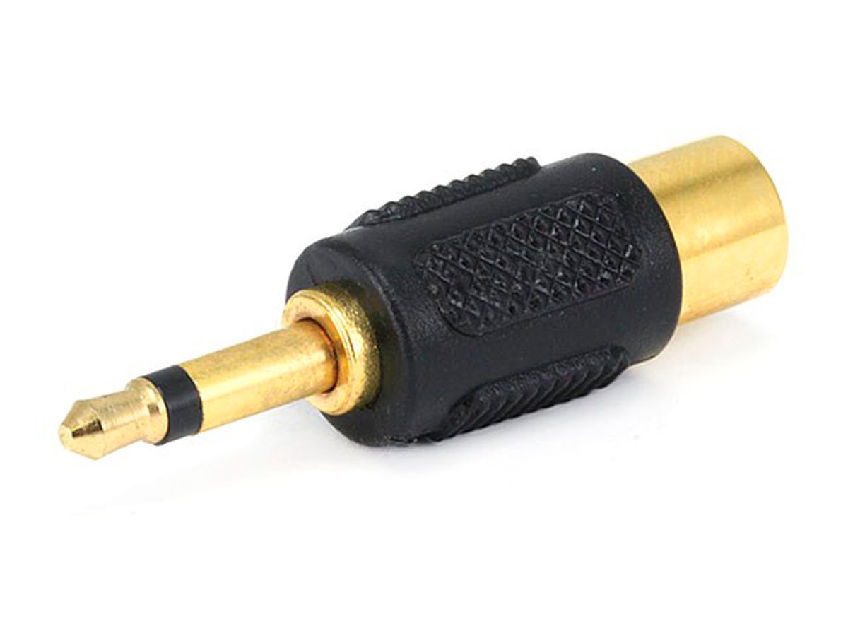

If you have not bought a sub I wouldn't. If you have you can try using a mono micro connector to RCA.
