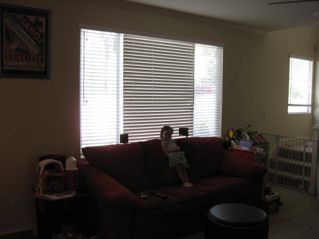

(I have windows directly behind sofa, but there is a wall to each backside of sofa. So, assume I could still use the PL-66 angled cabinets, although I can't direct those directly at listener, if you know what I mean).

Wife may be a little overwhelmed with a 3 speakers wall mounted. I told her why I didn't wall in-wall and she agreed.

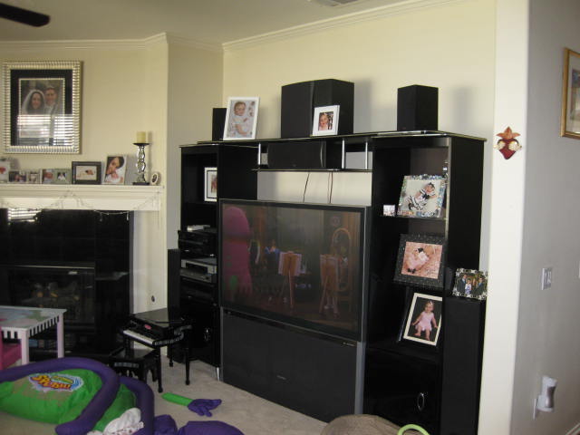

How deep is the recess that the current system sits in? It looks around 2' or so (from the edge of the fireplace to the wall behind the unit).

Yes. The alcove is 9.5wide x 2'deep x 9' to ceiling
Someone mentioned acoustic transparent screen. Can't afford it and wife doesn't want a huge screen there. Also, was planning on a built-in entertainment unit, but minimum bid was $4400, and that would wide out any quality equipement I get.
The problem now is wife is concerned about 2 year old messing with the towers. I don't want in-wall. Therefore, may have to go with wall mounted L/C/R around 60" tv?

Alcove was the word I was looking for :).
Genuine concern with the kid. Aesthetically, would towers to the outside + 2 subwoofers beside/inside of them (so that they cannot tip sideways, the main concern with towers, since most are far too deep to tip forward/back), then a media center between, work?

Looking at that photo again the alcove could be a problem. I would stick with either front ported towers poking out past the wall; or sealed or front ported bookshelves. I know from experience that rear ported speakers are a challenge in a tight alcove. You could wind up with corner loading like crazy. I'd use the sub(s) as an end table(s) next to the couch if there is any way to run the cable.

Can either of you comment on doing the SVS speakers wall mounted with the alcove depth that I have? In other words, because of the alcove, am I better off with towers on each either of an entertainment center? In addition, that may also force me to NOT mount the center speaker if the depth of the alcove is an issue. Aesthetically, I thought at least mounting the center would be nice.
You both got me thinking about the alcove and its affect on sound.

You could wall mount and see how they sound. And if you don't like the sound move them forward on shelves. I'd just try and have the L&R at ear level and the center as close to ear level as possible. You can always angle the center down a bit but I'd get as close to the screen as possible. Remember that you can localize the sound from those speakers (unlike the sub) and I don't think I'd want the sonic effect of conversations taking place 3' over the TV. But that's just me.
It depends on where you wall mount. To avoid the "bandshell" effect of excessive early reflections in the alcove, you would want to avoid mounting LR speakers on the 9.5' wall of the alcove (2' back from the face)...especially poor speaker designs with zero directional control (a quick peek at the SVS site showed just such tragic designs). Mounting them on the side walls of the alcove, flush to the front edge of the 2' wall and toed inwards...might work (how would you hide the wires?). The (362) towers protruding just past the front edge of the alcove is a safe bet for good sound. You could still wall mount the center under the TV or place it on the stand, etc.

A lot of this seems to revolve around what stand/entertainment center you plan to put in the alcove...and what takes precedence.

The only reason that I'd hesitate on the EMP is I believe (if memory serves correctly) that they are rear ported. I can't swear to it but I believe that's correct. If it's true then I don't think they would be a good choice for an alcove. In my experience the sound coming from the port may reflect off the front wall (behind the speaker), the side wall, and the entertainment system creating a megaphone like effect with the bass overwhelming and burying the midrange and highs. That's why I replaced the perfectly good rear ported towers in my family room with front ported towers. I had almost the same situation.
Generally I like to place rear ported speakers at least 2 feet from the front wall and 3 feet from any side walls. In your case even sealed or front ported speakers should have their fronts peeking out past the side walls and cabinet to minimize reflections.

The entertainment stand will likely be a typical black about 60" wide shelving unit. Positioned in center of alcove. Now, that leaves about 27" on each side. Obviously, each tower is not 27" wide. So, I either have to have each tower right at the edge of each alcove brought forward a bit, or I have them directly against the entertainment center with a small gap to the outsides of each speaker. I kind of figured having a little greater distance between the L and R is better?

It looks like you sit more than 9' back from the alcove, so yes, to the outside, slightly protruding from the face of the alcove, maybe toed in slightly. As I suggested before, in the gap between the entertainment center and towers, a pair of narrow subs to prevent the towers from possibly being tipped inward by the toddler. Something like a pair of these might be overkill (or bring law enforcement to the house), but would fill the gap nicely ;) and has a gain control on the front, behind the grill, so that you don't have to reach behind like most subs and the toddler can't "adjust" it with the grill on :).
