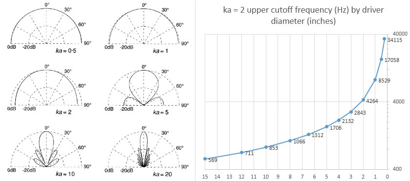

I'm sure you have also read that the xover must be at a frequency low enough to equal a ka of 2 in order to maintain constant directivity for example, a 5" woofer must have an xover point of 1.7khz in order to avoid beaming.
I have taken measurements and will be posting them with a review, but the premier series is design for constant directivity and displays constant directivity when measured.
the RP-150m off axis response, IR windowed, is
1.8khz-14khz +-45° laterally, -3dB at 30°, -6dB at 45°, at 45°, 14khz-20khz rolls off at -12dB, indicating that the horn loses control past 14khz. Klipsch follows the ka2 rule. Their 5.25" driver has an cover of 1.8khz, the 6" 160m has an xover point of 1.5khz. the rp-280f uses an 8' driver and has an xover point of 1100hz. The r-14m uses a 4" driver and has an cover of 2200hz etc etc.
