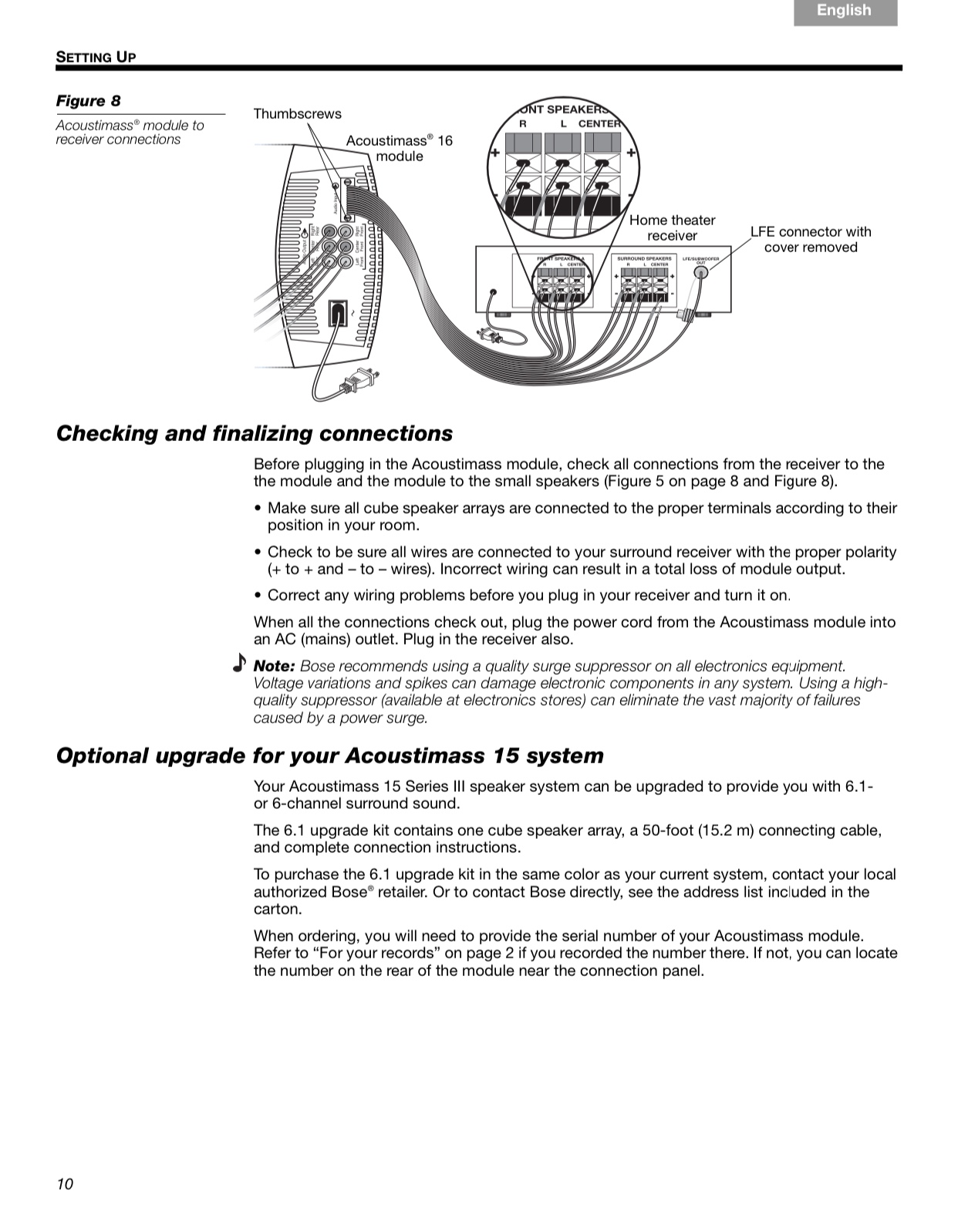

I could have used any combination to hook-up both Bose AM16 but I went with one for the surround and one for the heights and one LFE output for each. Since I did want to use all 12 speakers, I had to trick a bit so one Fosi bridgeable mini amp went for the surround back (had just one previously installed in my former surround set-up), I use both pre-outs to the amp wich feed a single back (helps in the settings afterwards to make the amp believe there are 2 speakers in the back!).
I've another Fosi to feed both rear heights (2 assignable, not amplified pre-outs) and finally the third one is hooked to another set of fronts speakers from the pre-outs in addition to the already amplified ones, so 4 speakers in the front.
I then have an actual 6.2.4 Atmos setup (amp thinks it's a 7.2.4) with 4fronts).
