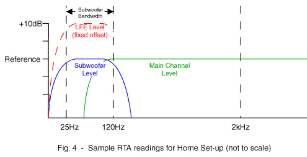

Right! The penny's dropped at what you're getting at now. :) It's really nothing to be concerned about Acoustat. What TLS Guy was saying IIRC, is that ideally, to give the best chance of achieving a good blend between subs and speakers, the subs should be capable of playing with some authority to around 1 octave higher than the crossover frequency. This is about re-assembling (in the room) what bass management (lows -> sub; everything else -> speakers) has pulled apart in the satellite channels. The .1 LFE channel is a whole other beast and you're not expected to blend it's content at the crossover. In fact, you can't: the .1 LFE channel content gets a 10dB electrical boost over and above the level of the satellite channels on playback. This enables it to not only "keep up" with the 5 or 7 satellite channels but to provide additional impact when required. This illustrates the arrangement:
(Note that the blue line is mis-labeled IMO. "Redirected bass" would be a correct description. "Subwoofer Level" is the sum of LFE and redirected bass.)
Hope that helps!
Glad to add to your body of knowledge KEW!
Excellent work.. The picture explains it exactly what you have been stating. :) I did not think there was any limitations of the Rythmik subs.
Thanks 3db. I can't claim credit for the pic - I lifted it from the Secrets article linked earlier.
