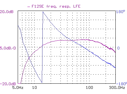

Looks like the first graph is for the amp that shipped in an older model of the sub and the second graph is from the one that is currently shipping with the sub. The newer amp basically extends the frequency reaponse of the sub all the way out to 200 hertz. The response is pretty flat from 20 hertz to 100 hertz which means it is going to play the entire range at very close to the same spls, so you wont have any frequencies that will play louder then others. Those are the graphs for the standard f15 sub at 974... shipping on the sub is goong to be around 90 dollars though which takes the price to 1070
jcparks
jcparks
Also there are two models of the F15
the standard F15 with a 370amp for $974 and the F15 high power with a 600watt amp for $1224
but it seems they both have the same frequency response.. from reading it sounds like the high power will play about 30% louder.

I do not understand Q values, except the lower the better the...? quality, accuracy, ability?
Oh no! I could read the HSU graph, but the Rythmik is Greek to me. I am lost. Not a good illustration
the one who drew up that gave no reference to color scheme and failed to make clear to me what was happening with the 2
or why two lines were involved.
You may know right off the bat just fine, I on the other hand am ignorant.
I see the difference in the additional low pass filtre comparison for sure.

. If the OP uses the LFE inputs, the sub will go to 200Hz.

Frequency Response 14 - 200 Hz (-2 dB @ 14 Hz) with LFE inputs
14 - 90 Hz (-2 dB @ 14 Hz) with LINE IN inputs

Frequency Response 14 - 200 Hz (-2 dB @ 14 Hz) with LFE inputs in A370PEQ3/XLR2/XLR3
14 - 100 Hz (-2 dB @ 14 Hz) with LINE IN inputs in all models

This is a simple proposition.
You can not use a down firing sub.
You need a crossover of at least 100 Hz to offload your panels, higher if we can manage it.
That means the sub must blend with your panels. Crossovers are not brick wall filters, and you need a bandwidth of at least an octave above the crossover point or the sub will not blend properly.
The HSU sub has a circuit to control Q and will operate as a low Q device. This means that the loading will be precise and defined. It will not spread like goo all over the place.
Now you will not use the crossover on the sub, you will use the line input connected to the LFE out on the receiver.
Then you set the crossover point on your receiver. You will only have to worry that you set the level and phase control correctly on the subs.
Now you can let Audyssey set speaker levels and distances.
The HSU I think will work fine for you and two are basically within your budget.
You really do need to replace the NAD with a receiver to offload your panels and send the correct signal to the sub.
There are a lot of well meaning people here who have no idea how to go about what you need to get the best integration of planar electrostatic panels and a sub, and also the unique problems of electrostatic speakers in particular.
The object is to get your nice legacy system updated and able to function in a music and HT environment.
At the same time we need to solve your need for greater spl, without blowing up your panels, which can easily be done with an ill thought out scheme.
So you need a sub, that can have its internal crossover by passed using the line input. It needs to be front firing, be low Q and have a bandwidth of at least an octave above 100 Hz and preferably higher to give you greater flexibility to further off load your panels.
You need a receiver with at least 2.1 preouts.
Do this and you will be set, and likely enjoy this system for many years to come.
Hook up and set up with the right equipment will be very straightforward.
