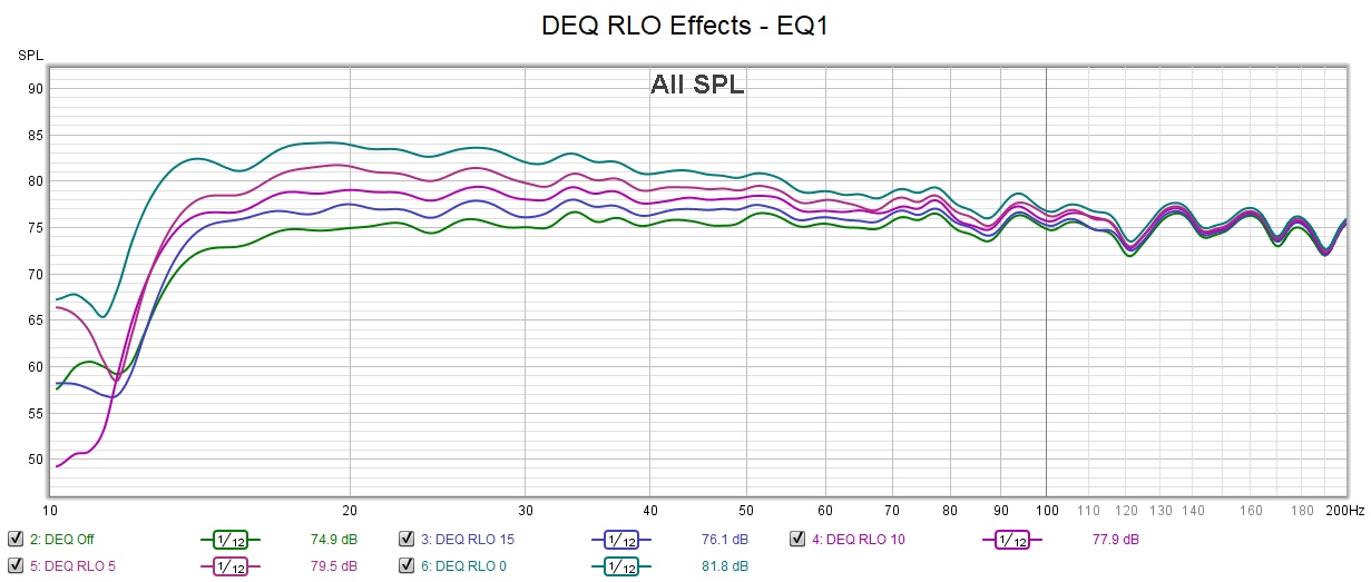

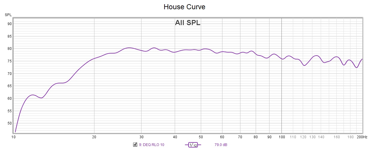

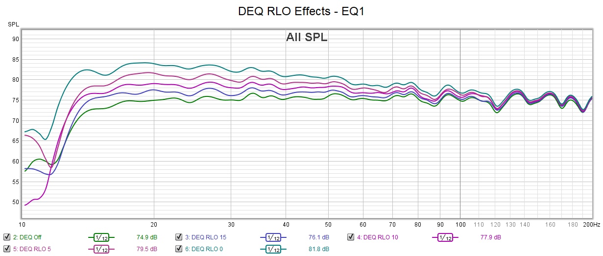

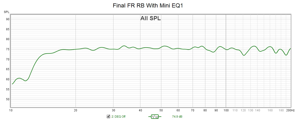

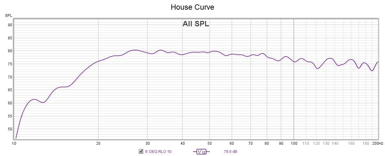

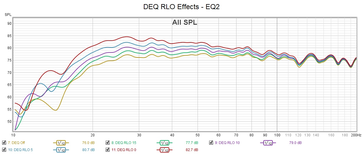

I never use dynamic volume, but do turn on DEQ, RLO 10. When I calibrate my subs (HSU VTF-3 MK5s) I use EQ 1, one port plugged, or "deepest extension mode" and go for as flat as possible, then use my subs' onboard tuning (pull the port plug and switch to EQ 2) and DEQ for the house curve. I did do a bunch of sweeps to illustrate.

View attachment 48286View attachment 48287View attachment 48289
I use DEQ as well. I know a lot of people who know their stuff typically advise against using it, but I've always liked the way it makes the bass sound in my system. I also prefer the bass measurements I get with it when measuring in REW. My measurements look similar to yours: without DEQ the frequency response looks fairly flat. However, with DEQ it has that overall tilt in the bass, which I find sounds much better.
I too like DEQ and I'm unsure why Dirac has not implemented something similar. With DEQ I don't like that it also increases the volume of the surrounds which in my room is too much and can make the front stage collapse on some material. I think it would be nice if Audyssey added a level offset for surround similar to reference level offset.
