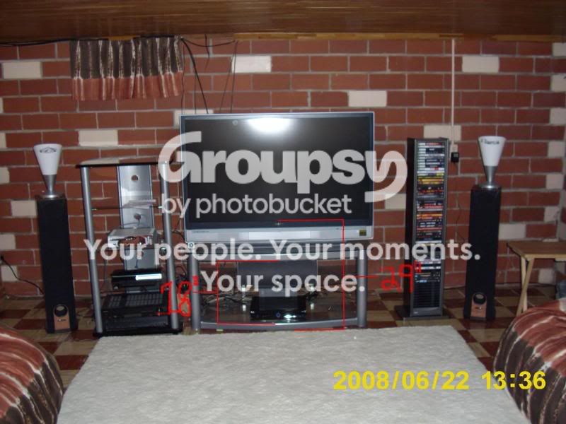

Here goes, im planning placement of the rocket center speaker which is 12" high. this will not fit on the middle shelf of my tv stand, so i have 2 options, but before i get to those do you think a speaker placed level right at the very bottom of the screen would sound (blend) better than one place almost on the floor angled up perfectly to ear height will sitting on the couch?
the reason i ask is this ..first i will show you my tv stand
now for the stands the first one being the best looking approach
would be if i removed the center shelf on the tv stand and put this stand there, when this stand is tilted at a 45 degree and it it is 6" high making the total of 18" witch is exactly what i have under the top shelf of the stand

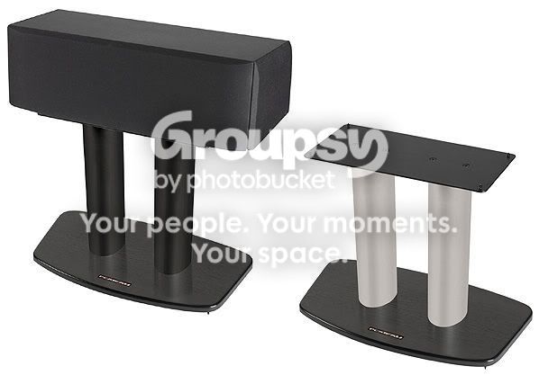

the second option is this stand
but id have to put it in front of the tv but it is 17 inches and the speaker is 12 witch ofcourse makes 29" putting the top of the speaker exactly at the bottom of my screen itself, and it would stick out like a sore thumb

I like option #2 because it gets the tweeters as close as possible to the same plane. Option #1 is pretty....expensive. :D I'm thinking you could achieve similar results with an old shoe box and 3 romance novels that you don't want anybody to know about. :)

option 2 i can get at amazon for 119.00 shipped ,the site i linked to just had a bigger photo, were you wondering if my walls were real brick? yes my whole house is brick ive only put 3 holes in the brick as i try not to tear it up, 2 for my rear surrounds and and one for a big lighted picture.
Wow, a brick basement huh? 3/16" Tap-Cons work great on that. What fasteners have you used on them? Yep, I'm taking a survey. :)
With option 2 you may need to raise your TV stand an inch or two to accommodate lay down viewing. How many romance novels you got? :D
