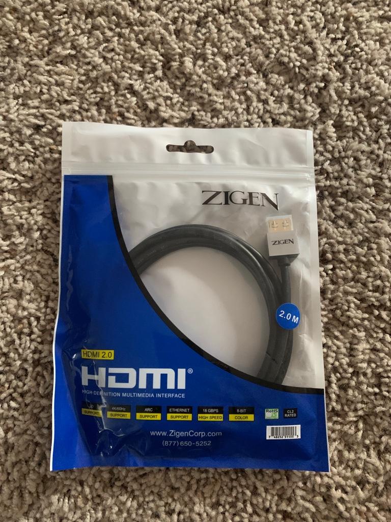

I’ve never been big on reading the manual. Anyway I’ll try the Zigen cables then, from the looks of the company website I’m going to guess they’re better at send video signals than Monoprice. I’m also going to search for the cat 6 cable recommended here and see how it goes. That’s probably cheaper than shipping.
Well usually the avr usb input expects a mass storage device which most phones aren't.
Why Zigen? I briefly looked at their site and they don't even use hdmi standard descriptions. Probably some bullshit I'd guess, especially just basing performance off the look of their website, seriously? Monoprice cables have always done fine for me if you pick the appropriate one....but good luck.
TankTop5
Why Zigen? Mostly because they were free. At this point though I’m willing to say the Marantz is the issue. I don’t read read widespread issues with HDMI cables although I’m sure some do have issues. I replaced Monster cables with DPL certified 18gbps cables (all DPL certification means is the cables do what they’re advertised to do) that exceed the spec it takes to send a correct signal it takes to make the handshake and send enough bandwidth. Seriously it shouldn’t be this hard and if it is I doubt it’s the cables. When a customer of mine says their truck is running rough I may ask where they filled up last but I’m not going to suggest they try racing fuel or jet fuel before checking the engine. I’m aware that’s an apples to oranges comparison but the Marantz should be just fine with some above average cables and I shouldn’t have to spend this much time or effort to make it function as designed.
