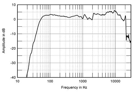

It seems the PSB measures a lot better also.
Cantan Vento Stereophile:
PSB Synchrony Stereophile:

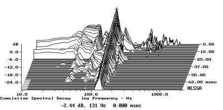

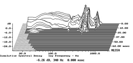

hi,
First tiem I'm reading these diagrams, from my layman point of view, it looks as though the PSB achieves larger (thus more comparable to higher frequency) sound waves in the lower frequency?
anything else to deduce from those charts?

hi,
For the 2D graph, you would like it flat, not lumpy. Now if it has to be lumpy, one would prefer that the lumpy area is not in the critical midrange area where our voices and instruments lie. The PSB is very flat from 500hz to 1200hz, whereas the other has its very worst jaggedness at this critical area. The PSB tails off or gets lower way up in freq, and this could be a signature of the brand name (considered warmer).
The Canton is flatter down low to its usable freq extension than the PSB, no question, but I'd rather take my compromise down in this area than the opposite.
The 3D graphs can possibly show you how "tight" the sound is (this is just one graph/measurement, and not the whole* picture but still). The Canton obviously suffers ringing so badly just above 100hz, it is literally "off the charts". Now this problem at 131hz does not necessarily have to show itself as some enormous peak; it's that when this frequency is played/excited, it keeps ringing on for a very long time, respectively.

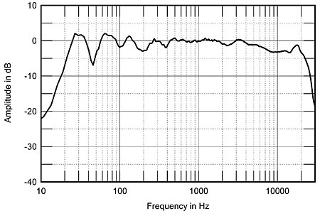

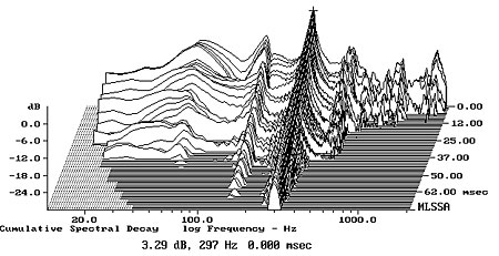

What I found from Stereophile for the PSB Imagine

Are the Stereophile measurements of the Canton's and PSB's anechoic? If not then I wouldn't put too much stock into them. Let your ears decide which sound best.

I had to look up anechoic =). Meaning were those done in a echo-free room? I'm not entirely sure, but I guess what you're suggesting is that my room is definitely not going to be anechoic so those may not apply?

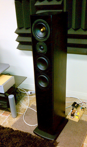

Is this the Ascend Acoustics Sierra-1 Tower?
Hi Yes that is,
They actually have several blacks, a sand, 3 different types of glossy black with the glossiest being called piano black which is an extra $700!
can't tell which one that is, but those look great from that angle. My only gripe is that being all black is a bit boring, I would have preferred a slightly different color cone, or brackets around the cones being metal, etc.
Did you get to hear that? any thoughts?
