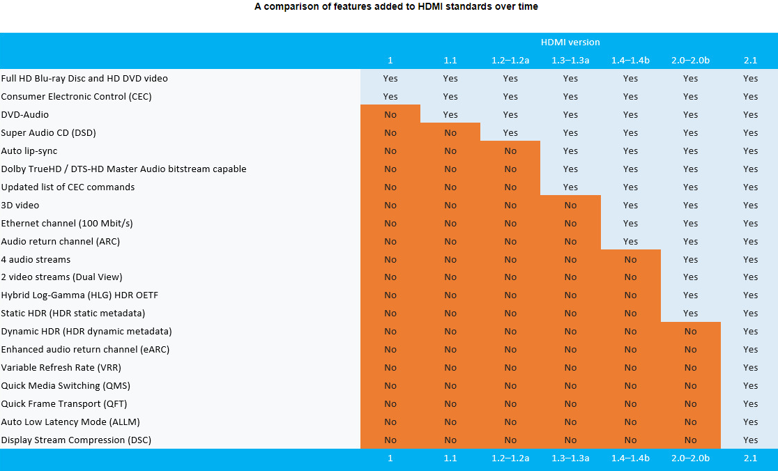

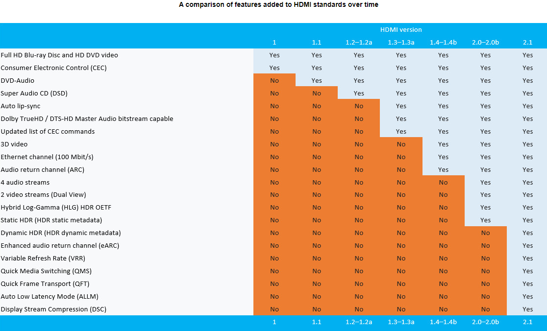

Here's the HDMI Features added to standards over time, and ARC is in 1.4. See photo below.
But you will be better off going through the receiver via HDMI as you can play Tunes, without having the TV on.
