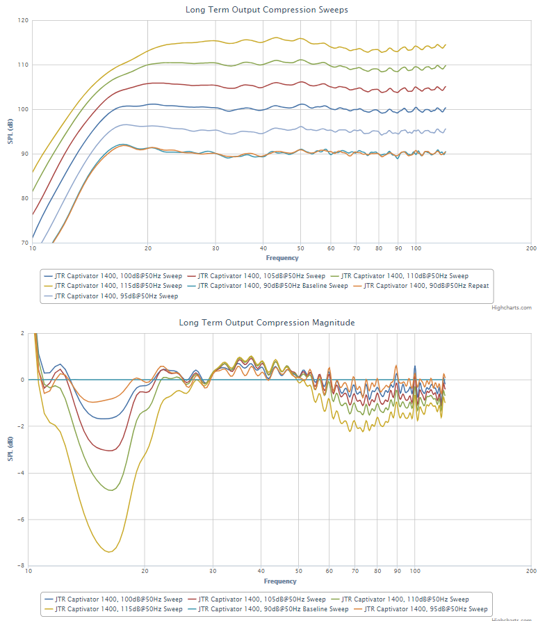

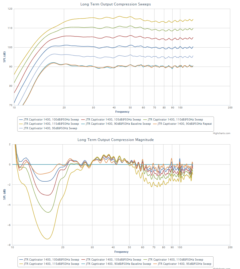

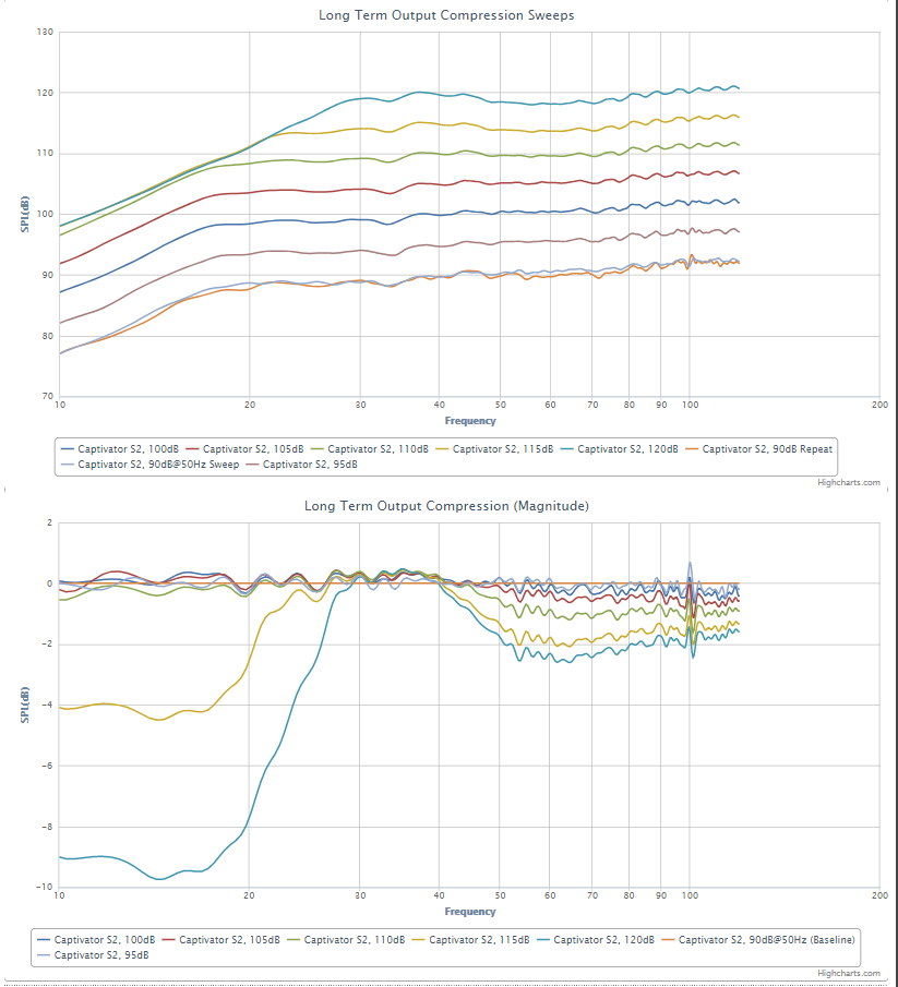

To be clear, I've got nothing against ported subs. I think the FV18, Monoprice, VTF15, et al. would do just fine in Ryan's new 2000cf space.
OTOH, as James noted above, given their relatively flat response outdoors, in a real room (and particularly in smaller spaces) those subs can get bottom heavy due to cabin gain. While EQ can solve that problem easily enough, I prefer aiming to get a sub whose low end response matches up reasonably well with the room its going in. Seems more elegant to me vs getting a big ported box with the foreknowledge that you're probably going to have to pad down output in the bandwidth where the port is doing its business.
Of course, there are other advantages to consider as well. Extension into the single digits has been mentioned, and is viable contingent upon cabin gain and enough subwoofage to make it meaningful. Beyond that, there are no ports to chuff or compress. The latter is something that tends to get overlooked in comparisons that focus solely on max output. Consider the case of the JTR Cap 1400 vs the S2. At 16Hz, the CEA charts rate the ported Cap 1400 as the champ. Looking at the long term sweeps and the compression figures tell another story:
Looking at the Cap 1400 first, it's clear that the port is progressively compressing from the 95dB sweep on up, even as it continues on to deliver over 108dB @ 16Hz. Conversely, the S2 exhibits negligible compression on the low end until the system finally runs out of gas. That's an important difference, and one area where CEA burst testing doesn't reflect the reality of how we use our systems. We aren't running bursts at progressively increasing levels till our subs beg for mercy. We're calibrating them to deliver a particular response, setting a master volume level on our AVR or pre/pro, and letting our choice of content do the rest. Compression is a problem there because it means we aren't getting the output we expect from calibrating our equipment, and it's not something we can readily resolve with EQ.

View attachment 26489View attachment 26490
