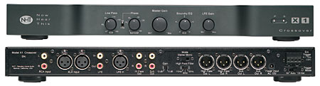

I think one case of “pseudo-passive” bi-amp might have more benefits for experienced Audioholics.
This case has been done by NHT (Classic Four tower) and RBH (SX/SV Towers).
The external amp needs to be an amp with a high-pass/subsonic filter and volume/gain control. Crown amp has 30Hz HPF, Yamaha has 20Hz HPF, Dayton has 18Hz HPF, RBH has 16-40Hz HPF).
Assuming the Crown amp is a power amp and you are keeping the internal crossovers of the speakers, I would say such scheme is not a good idea because you are cascading the filters of the amp and the speaker's internal crossovers. Good or bad results will be luck/hit and miss dependent.
Well, It's not something I thought up all on my own. :D
1. S&V did a review on that NHT Classic Four using an external XO/amp to do just that. NHT advertised it. The speakers' internal XO are intact. So this is not considered fully active.
https://www.soundandvision.com/content/nht-classic-four-surround-sound-speaker-system
2. I spoke to Shane Rich RBH Chief Engineer about doing the same thing with the RBH SX-6500/8500 towers, and he agreed.
If it were a hit/miss/luck issue, I doubt NHT or RBH would be recommending that. :D
From S&V:
Bi-amping the Classic Four requires removing the speaker "jumpers" that connect the bass driver to the upper three-way system and routing the front left and right channel outputs into the X2 crossover. This is easily accomplished with a system of separates consisting of a preamp/processor and multichannel amplifier. It can also be done with an AV receiver that offers the flexibility of both preamp output and power amp input connections. You'd run the pre-pro (or receiver's) front L/R preamp outputs full range into the X2's high-pass filters to remove lower bass from the signal, then feed the X2's output to the front L/R amplifier channels (or the receiver's L/R amplifier inputs). If your AVR only offers line "outs" and not amp "ins," you might be able to use the receiver's internal crossover to filter out lower bass, but for the best match make sure your AVR's crossover slopes match the 12dB/octave slopes of the NHT system.
Either way, this results in the front L/R channels' amplifiers feeding a bass-limited signal to the Classic Four's upper speaker terminals, while the X2's outputs feed lower bass frequencies to the A1 amplifiers, which drive the Four's side-firing 10" woofers.
