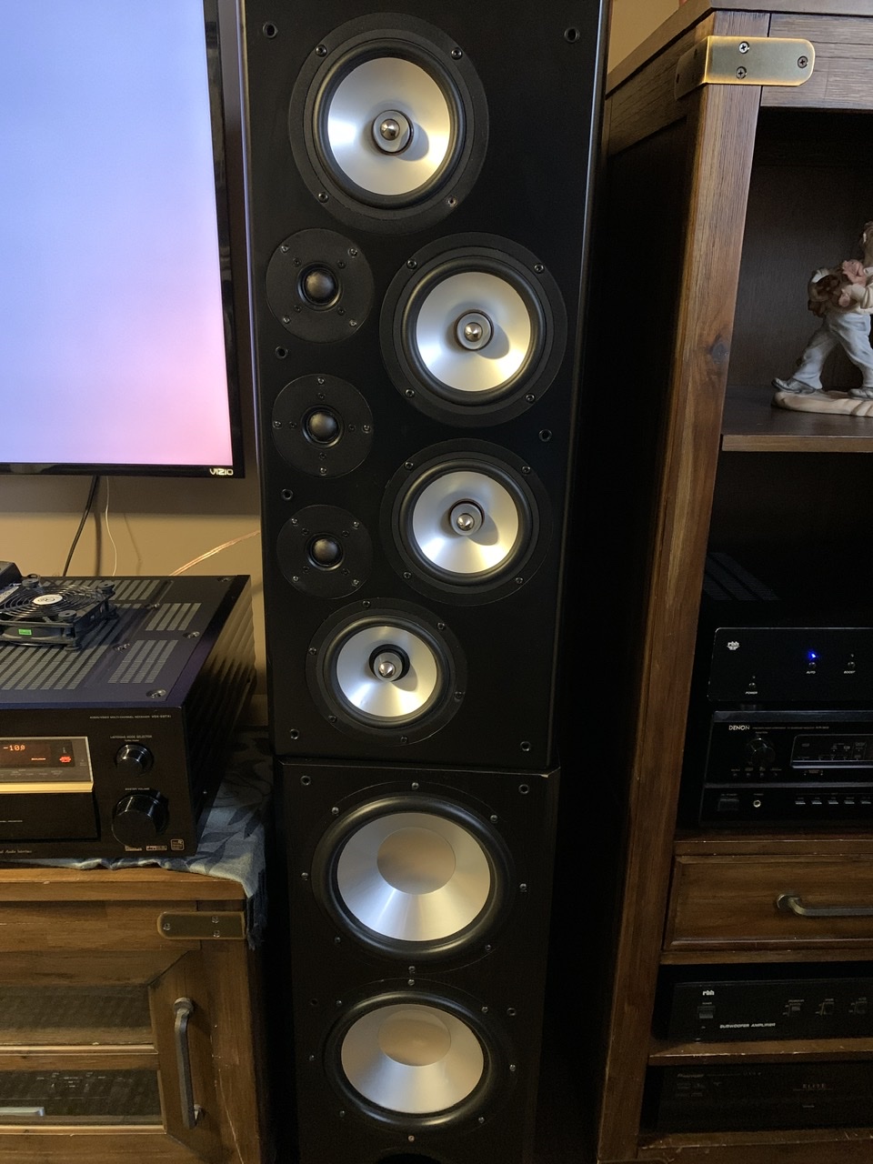

Been messing with a wonderful problem. I’ve got a new pair of SX-T2 speakers in my environment. There are so many ways to configure.
I do a lot of two channel, and desired to have a full 16hz-22khz for stereo. I have two SA-400 amps driving the bases. I have my receivers high level output going into the SA, through the 100 Hz filter that runs the upper towers, then out to the subs.
I’ve configured my receiver to a 5.0 system, and so far it seems to scratch my itch for low end. I’ve also mused over allowing the uppers to run full signal, then set a 50hz crossover and set the sub bases as dedicated subs, but I would loose my full stereo low end.
I had a very powerful pro amp powering the bases, but the low end was so weak I could never strike a balance between the upper tower and the subs. I’ve ordered a device that will allow for higher voltage to pass in to the amp, but the SA-400 amps seem to be more than adequate.
Im just looking at what folks are doing out there. Thx

With the proper quality of components, they absolutely stun the listener with a massive sound stage, tremendous speed with transients. The bases house four 10” Reference class drivers that puts pressure waves right through the roof, I know because it freaked out my roofers. As for cost, I could never afford such a beast if it was not for RBH having a garage sale.
I’ve never heard a set of speakers like these. The entire room disappears. They are really something special. I expect my days of chasing the audio rainbow are done. I won’t ever top what I have now. I’ve been so lucky.
