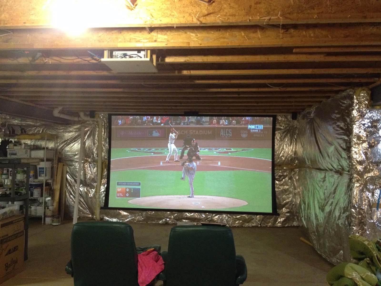

The GT1090 isn't a bad model. It doesn't really do HDR and the added lumens are (of course) a complete lie because of how they use their color wheel. More like 1,000 lumens when calibrated. (Don't believe the hype!)
Still, a respectable entry level model.
For reference. This is the W1070 from BenQ, which is brighter when calibrated, on a 161" diagonal screen with some lights on in the room. Unfinished basement space.
I would consider the 'best' projector overall. But, I'm not going to knock the Optoma.
Be very aware that short throw models are tough to get exact replacements for. I would strongly encourage you to run conduit or a pathway from front to back in the room that allows you to put a HDMI cable anywhere along the way.
