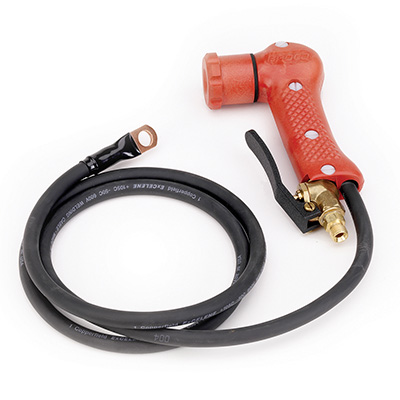

How would underwater ship salvage operations happen if cutting torches don't work?
If you didn't click on the link, you missed "The Broco BR-22 Underwater Cutting Torch and Broco Exothermic Electrodes are featured in the U.S. Navy Underwater Cutting & Welding Manual".

I did look at it. It does not sound highly practical to me, and clearly hazardous to the operator. I doubt there are many skilled enough to do this and it would be very slow going.
My guess is that they will craned out the remnants they can, and use controlled depth charges to make all remnants able to be craned out.
