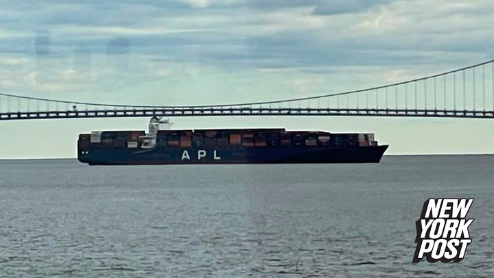

Hopefully, the Dali doesn't indicate a growing problem-
:D
