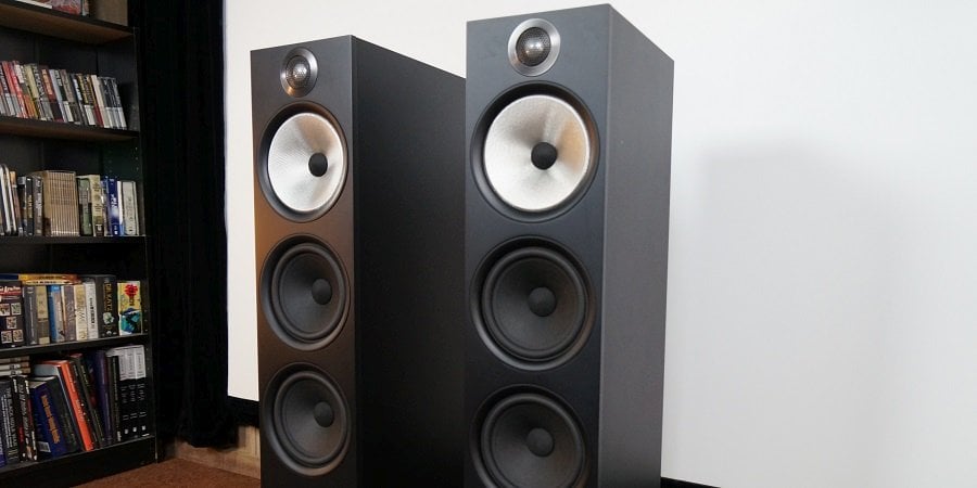

The 600 series from Bowers & Wilkins has a relatively long history for a speaker product line. First introduced as an entry-level speaker line in 1991, it has gone through many versions for almost 30 years now. In 2018, B&W unveiled their sixth iteration of the 600 series. This latest iteration takes advantage of a slew of technologies developed for their flagship 800 D3 series. In for review today we have the 603, the tower speaker of the new 600 series. Even though this is an ostensibly entry-level speaker, it is still an somewhat expensive proposition for a speaker set at $1,800 a pair. For Bowers & Wilkins, ‘entry-level’ is not some pre-determined price point but the answer to the question of what kind of speaker can they design that meets certain minimum requirements as cost-effectively as possible. In other words, what is the least expensive speaker that can be made that sounds and looks great? When one is accustomed to the extraordinarily high-fidelity that B&W is known for, that significantly raises the bar of what is considered ‘minimum requirements,’ so the 603 should deliver that B&W listening experience for a relatively accessible cost. In this review, we will ask whether the 603s deliver on the promise of a high-end B&W listening experience without the high-end price tag.
READ: Bowers & Wilkins 603 Tower Speaker Review
