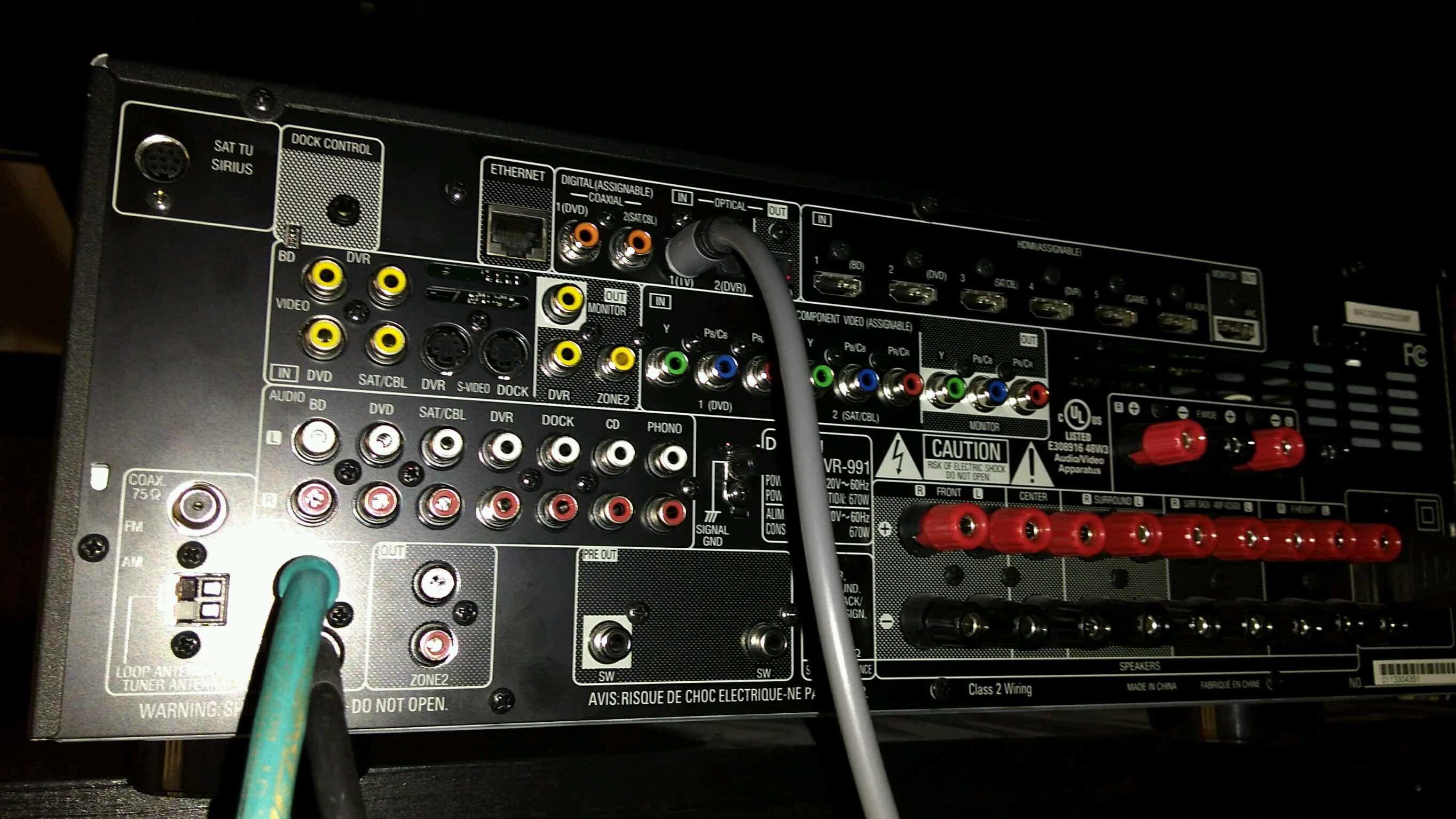

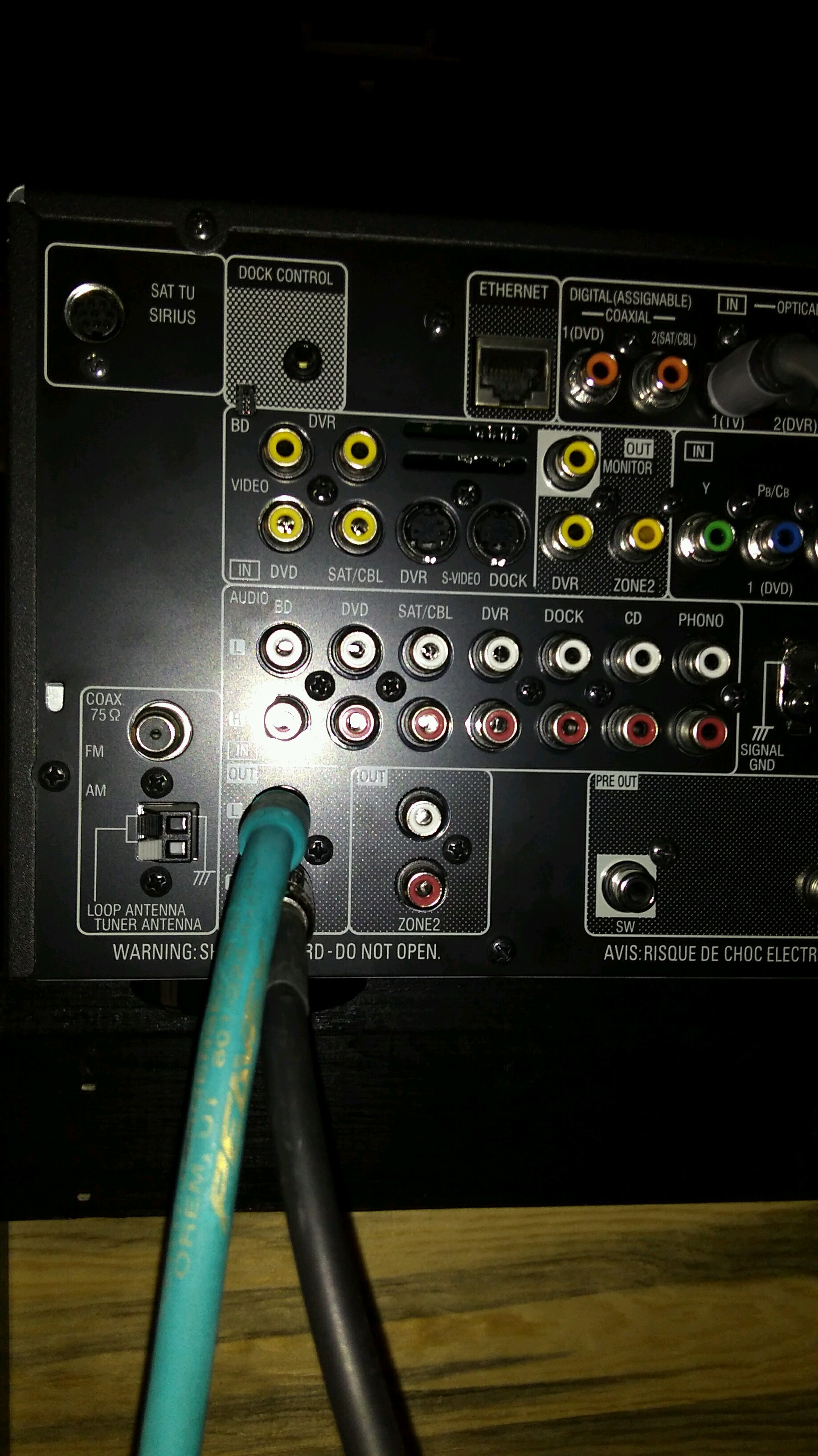

Hey, lovinthehd! Thanks for the quick response. I appreciate your help. Below are a few pics of the current setup. The grey cable is the optical, the green & black on the left are the XLRs. They are currently plugged into the DVR Outputs, that was the only one I could get to work. There are Pre-Outs to the right of that, as pictured.
What do you recommend?

I only see zone two pre-outs plus a recording output (which as you said may explain no volume control). Found the image of the rear of the unit with a search fairly easily, tho.

View attachment 22212 View attachment 22213
Move the connectors to the zone 2 pre-outs (and use zone 2 for control), should get volume control that way, the volume is fixed on the outputs you're using (it's for recording purposes).

@benjibliss Look at the "Pre-out" boxed section in your pics. The only true pre-amp outs that you have are for the subwoofers (SW). What you need is a main L/R pre-amp output (and clearly you don't have that).
So, as HD said, those cxns that you are using are fixed-level, the volume knob does nothing to that output.
