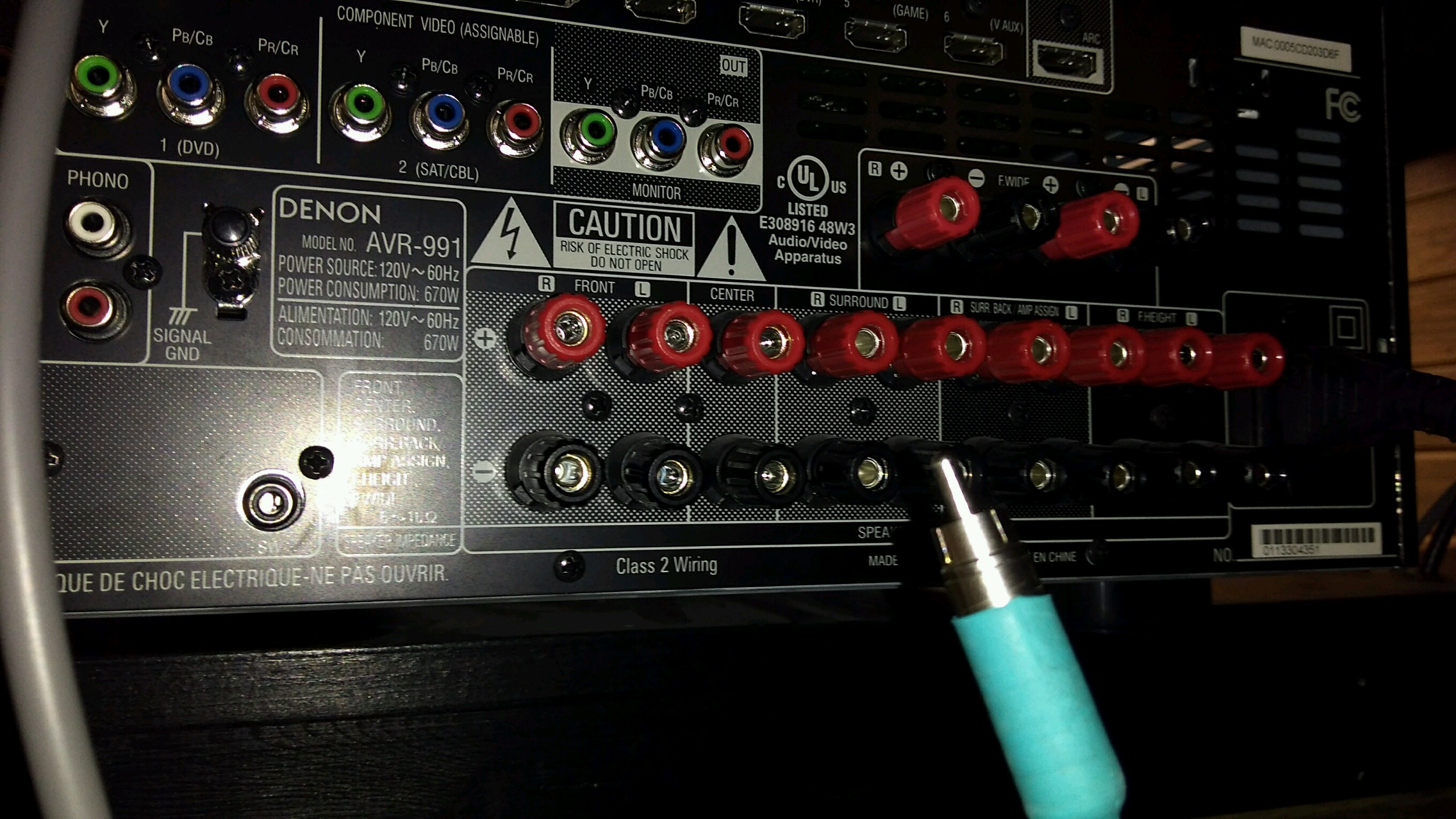

Call me crazy, but if I stick the female RCA on the end of male and then hookup the speaker wire to the receiver... it should work. Right?
OK, you are crazy, your words not mine :D
Did you try it yet?
That really is not a good idea! Speaker outputs are high-level outputs, you need a line-level (low level) output that also has volume control.
What you are trying to do is not a good idea, and may cause speaker damage. To do that properly, you really need to attenuate the speaker output back down to a line-level signal.................
