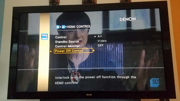

Here is what I came up with is there something I should shut off?
scottyb70
What are the choices under control other than all? Is there an off?
Hey Just to let you know, I solved it. It was in the Denon not the TV, if I can remember correctly it was in the HDMI settings like lovingthehd mentioned. Thanks working now.
