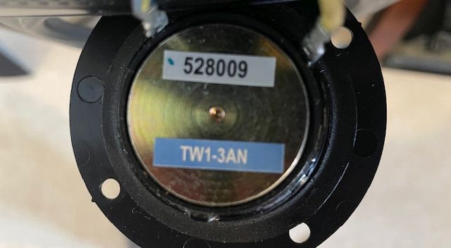

I think I know the couple of events that caused the initial damage and they were completely accidental. Pisses me off. I really would like to get stalk tweeters for them.
Pic of the tweeter

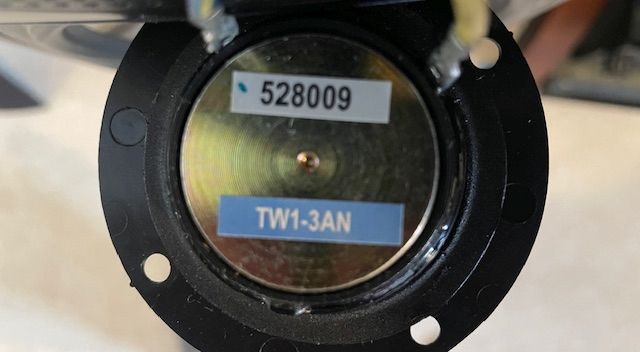

Pic of the tweeter
I think those speakers are still current, so they should be able to send you replacements. My guess is that these are Audax titanium tweeters fitted with a waveguide.
I would think PSB will send you replacements. If not see if they will give you the TS parameters of the tweeters. Modifying the crossover to take an Audax Titanium tweeter should not be all that difficult.
By the way, fessup! How did this happen?

This tweeter doesn't seem to be the same unit as the one shown by @3db. Unless it has the same or very close Thiele/Small parameters as his, there's not much possibility of a successful match with the other drivers in each cabinet.
The back looks identical, except for adding G in the model number. $35 as far as parts-cannon-diagnostics goes, it is pretty cheap if you ask me.
