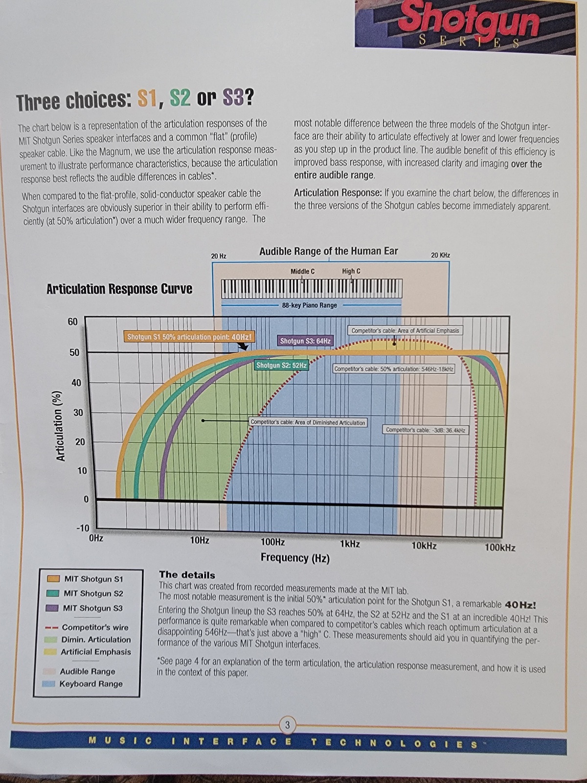

I did look at information on the Shot Gun box. Nowhere is there any coherent explanation of its design or function. Everything written about it is all in Audiophool gobbledygook, otherwise known as codswallop.
Yeah.. Crazy that I couldn't find a Pic of someone opening it up and taking a Pic after all these years. Who knows, could be empty
