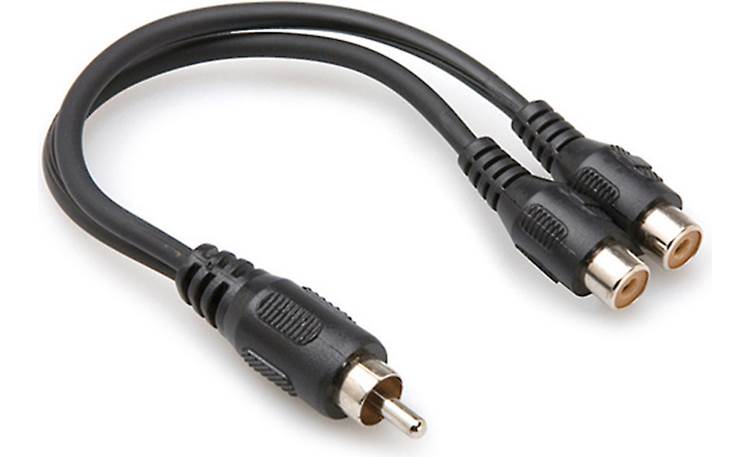

Any preference here or would both likely perform as well? Following are the links:

Thanks for the feedback.....I'm currently using SVS soundpath cables from my AVR's pre-outs to my Amp. I want to keep those and not introduce new cables or as little as possible. If I follow you, you are suggesting a Y splitter directly from the AVR pre-outs to the amp and finding a Y splitter of high quality and the needed length (about 3-4 ft) is a bit tricky....although I'm sure they exist....plus don't want to buy new cables and then have a hodge podge of cables connecting my AVR to my Amp....want to stay consistent. Oh and paid a decent penny for the SVS soundpath cables too!

SVS doesn't carry Y Splitter cable but they do have the adapter I linked in a previous comment here. I'm sure your point is valid, which may make me want to lean more towards the previously mentioned adapter, I would be adding a connection but no more wiring to the link. I also listed a Y splitter cable that I think is high quality in the same comment. Your feedback IS appreciated!

Actually now that I'm reading ALL the reviews on the Y Splitter wire adapter I linked I may be changing my tune on the quality of that cable. Seems as though it may not be up to snuff.

A single male to 2 female splitter or custom cable is what you want for this... if it is a good connection, the potential degradation is minimal. That said, you always want to minimize connection points.
If using an adapter, you will need something like this:

I used 2 of these (not that exact one, but basically the same) on the L/R preouts to my Monolith when I tried passive bi amping my Ultra towers and they worked great.
A pair of these would work too if you're under 12" from receiver to amp, and they look cool too.
