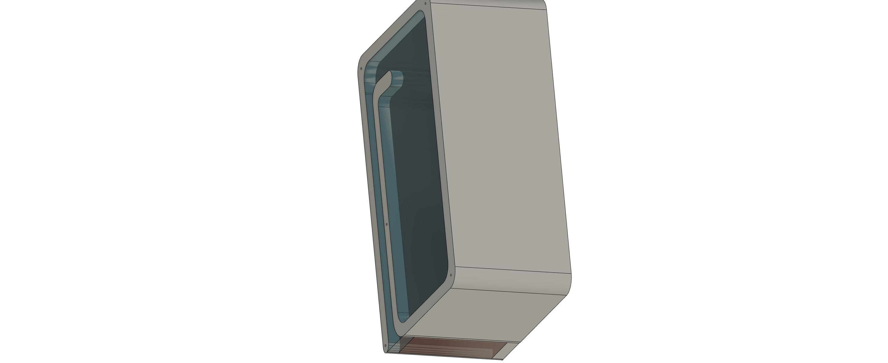

for driving a set of Dayton Audio RSS460HO-4 18" Reference HO Subwoofer 4 ohm in a ported cabinets which do you think would be best suited for powering them
either a Crown XLi 2500 750W 2-channel Power Amplifier or the Crown XLS 2502 775W 2-channel Power Amplifier
in a layered ported cabs tuned to 21hz with either 750watts at 4ohm (xli) or 775watt @4ohms (xls) an a 4th order high pass at 16hz from my outlaw audio 976 receiver
with a 44in long 12in wide 2.5in high flair port
the walls of the cab will be 1.5in inner 1.75in port wall an outer wall of 2in thick
with an net ft3 vol of 3.8cft
so with walls this thick an a epoxy resin coat in an out i dont think id need any extra bracing
the inner cab dims would be 35in h by 16.7in w by 12in d
outer dim 38in h by 24in w by 15in (1.5iin front an back panels with a .5in flush cut for the driver)
i plan to build two matching cab an run off
whichever would be better with load an sinad
you thoughts including paint on color

If the purpose is for public performances, I would rather recommend the QSC RMX 2450 which has better specs than the Crowns. Moreover, you can't kill those QSCs.
However, these QSCs don't have the DSP feature which the Crown has. The cabinets would be tuned at 21 Hz. So, do you intend to drive the subs below that frequency? If not, you wouldn't need a high pass filter. The purpose of the HP filter is only to protect the driver from over excursions below the box tuning frequency.
I noticed that the cabinet sizes which you intend to use are good for a sealed design. For a ported design, you would need 7.5 cf as per Parts-Express recommendation, and I entirely agree with them. Keep in mind that P-E and Dayton are owned by the same people.
Also, the amplifier would have to be installed in a rackmount or a cabinet with adequate ventilation.
  • Like
Reactions: lovinthehd
How did you determine the box/port details? Did you actually model the subs with something like winisd or bassbox pro? Or following someone's particular modeling? Like @Verdinut says, seems small for a ported design per Dayton spec.
The amps are similar, altho at one point Crown suggested to me the XLi may be better suited to sub duties, but I use XLS on my subs in any case. Don't know about fan noise on the XLi, seems I've seen reports of noise on the XLi so you might want to look into that if the amps are out in the room; the XLS is very quiet in any case. The XLS2502 was measured at audiosciencereview.com, as well as the 1502, but think they only have one for the XLi800. IIRC the XLS performed better. The XLS dsp is more about a crossover between a sub/speaker rather than go low enough for a protective filter below tuning (if needed). QSC would be an option but if you wanted even better perhaps something from SpeakerPower....
