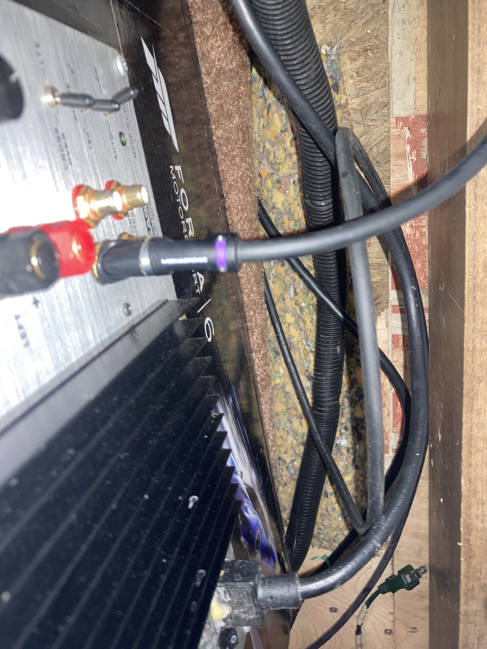

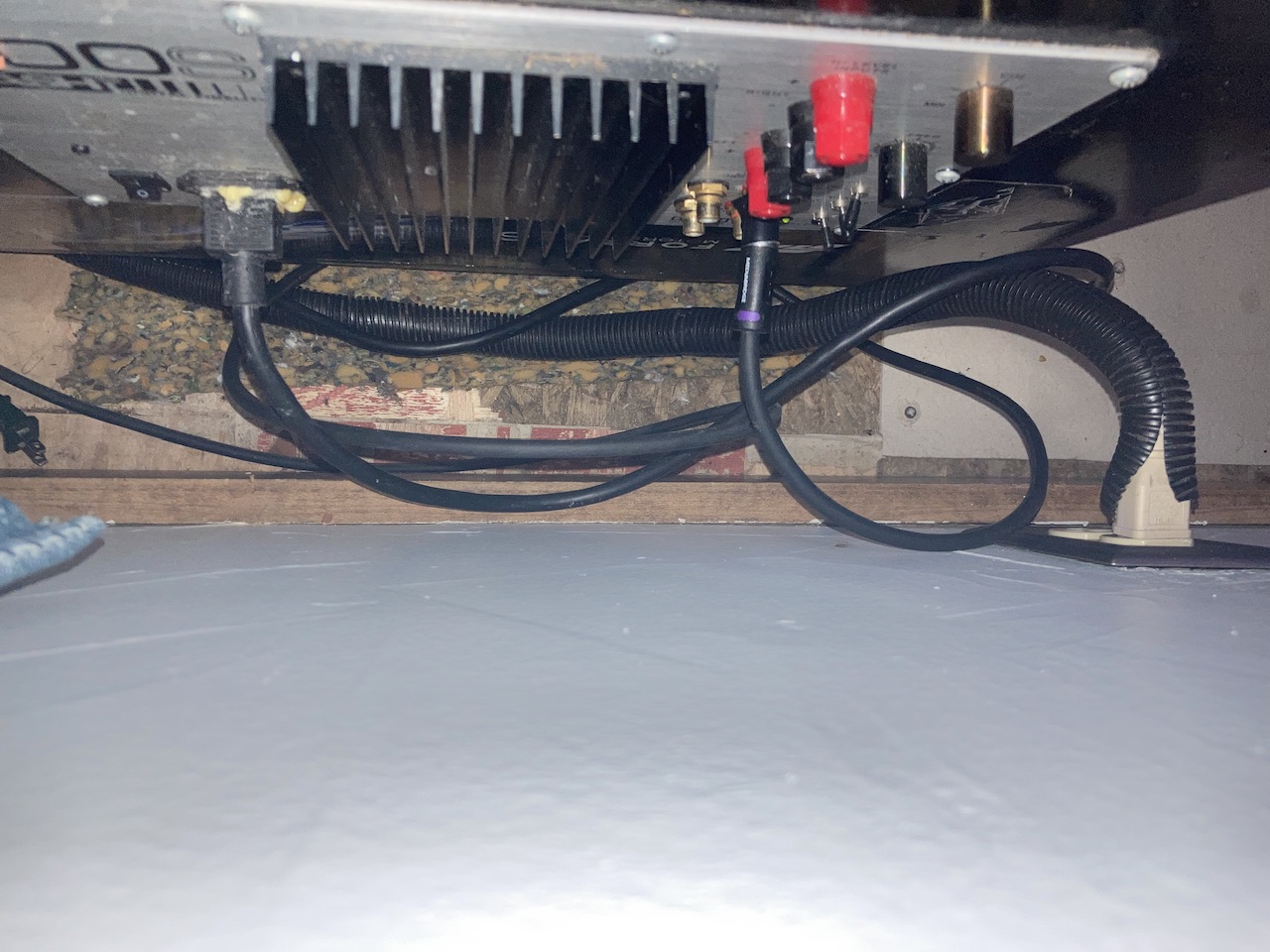

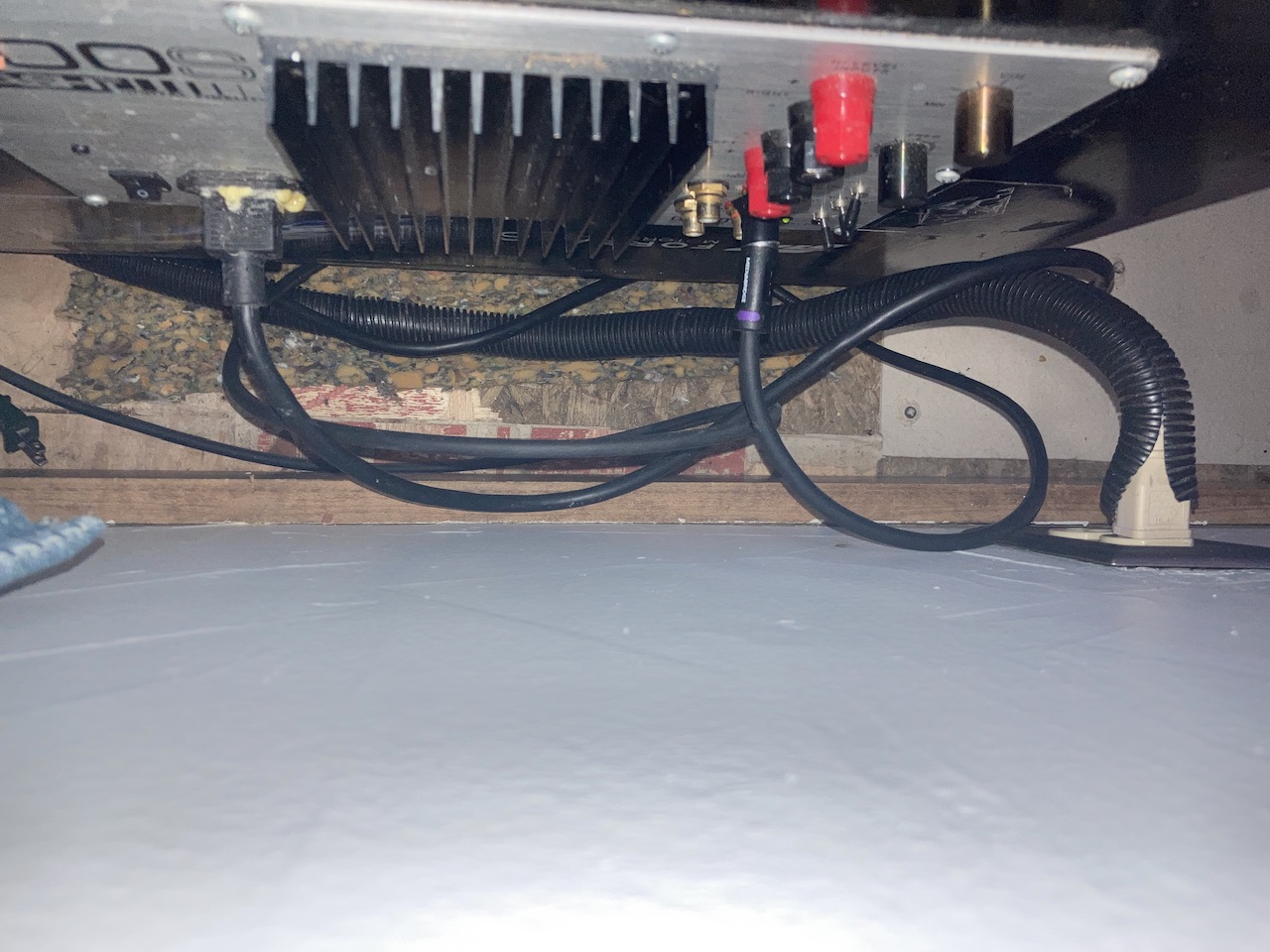

I noticed my newest cable how durable was it ?? still works but trouble , keeping it secure . Pushed too close against the wall ..
Yeah probably no one can tell …
Don't push it so close to the wall- the amplifier needs space in order to prevent overheating.
Sub ideally should have a bit of space from the wall too.

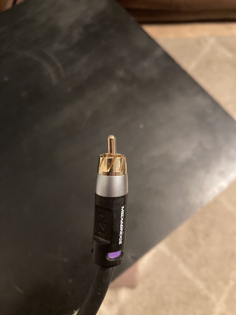

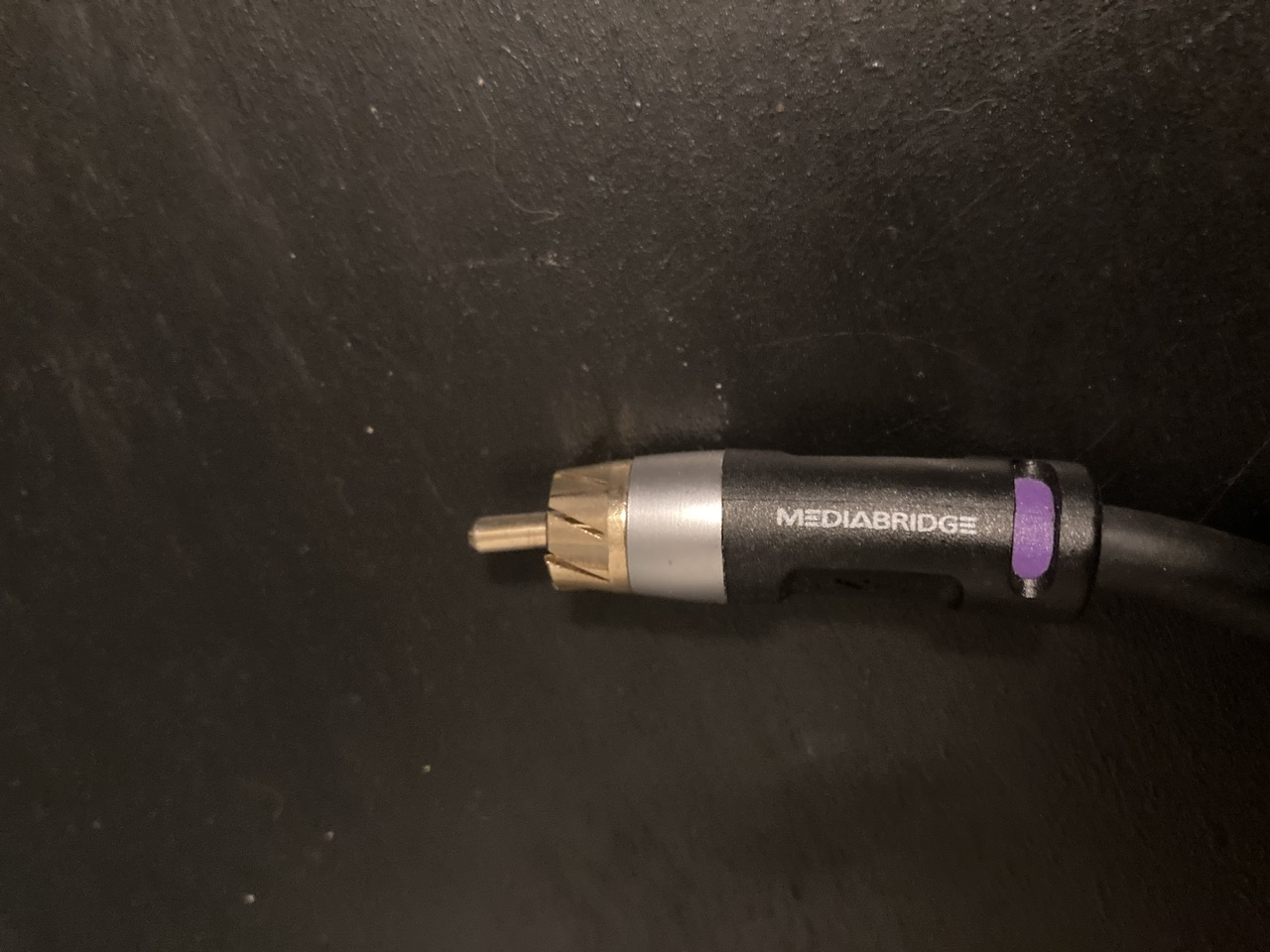

The Bluejeans connectors are even longer than that, as they have a cover that prevents flexing at the attachment point to the connector body so they don't get damaged. That presumably will help protect the pin as well.

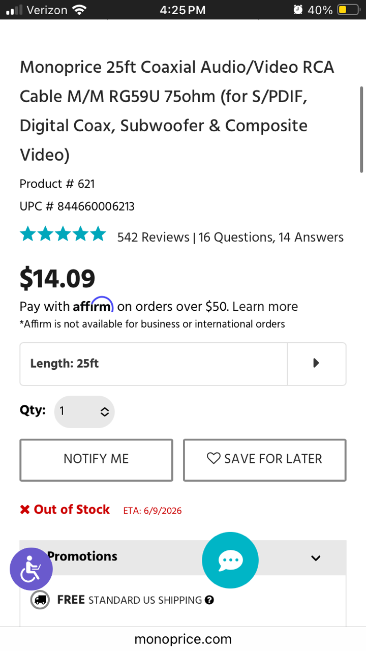

Yeah wonder if they got right angle adapters ? Since this and the monoprice and cable I was looking at don’t have right angle connections ?

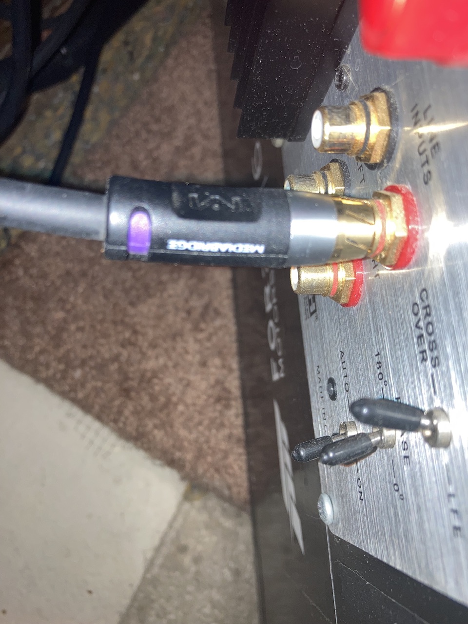

odds are it got bent with the jamo sub. Prior to connecting it to this one. Too close to the wall??

odds are it got bent with the jamo sub. Prior to connecting it to this one. Too close to the wall??View attachment 78277
Should be OK that far. A little more room helps, but 3-4 inches should be good. I have used the right angle connectors and they work fine as well.

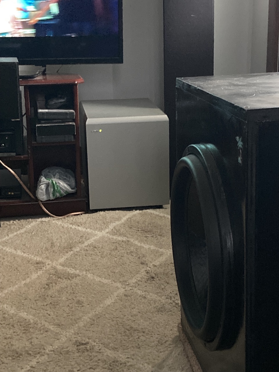

jamo sub already broke one cable because it was crammed in a corner now I moved to front of the room with more space but it has to work a lot harder then the DIY sub being farther away and smaller .
Right angle adapters are available- not terribly expensive, either.

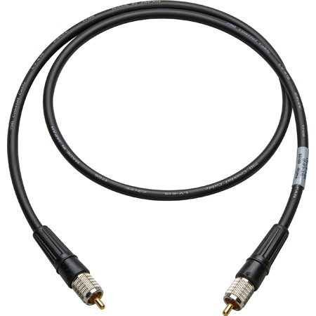

For an incredibly nice cable, Canare makes a coax with stranded center conductor for extra flexibility and matching crimped connectors.
Wow interesting. I searched it on amazon and found this but it would be too hard to split such a Cable?
They also sell various right angle models . Not sure which brand is best ??

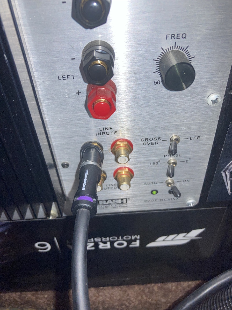

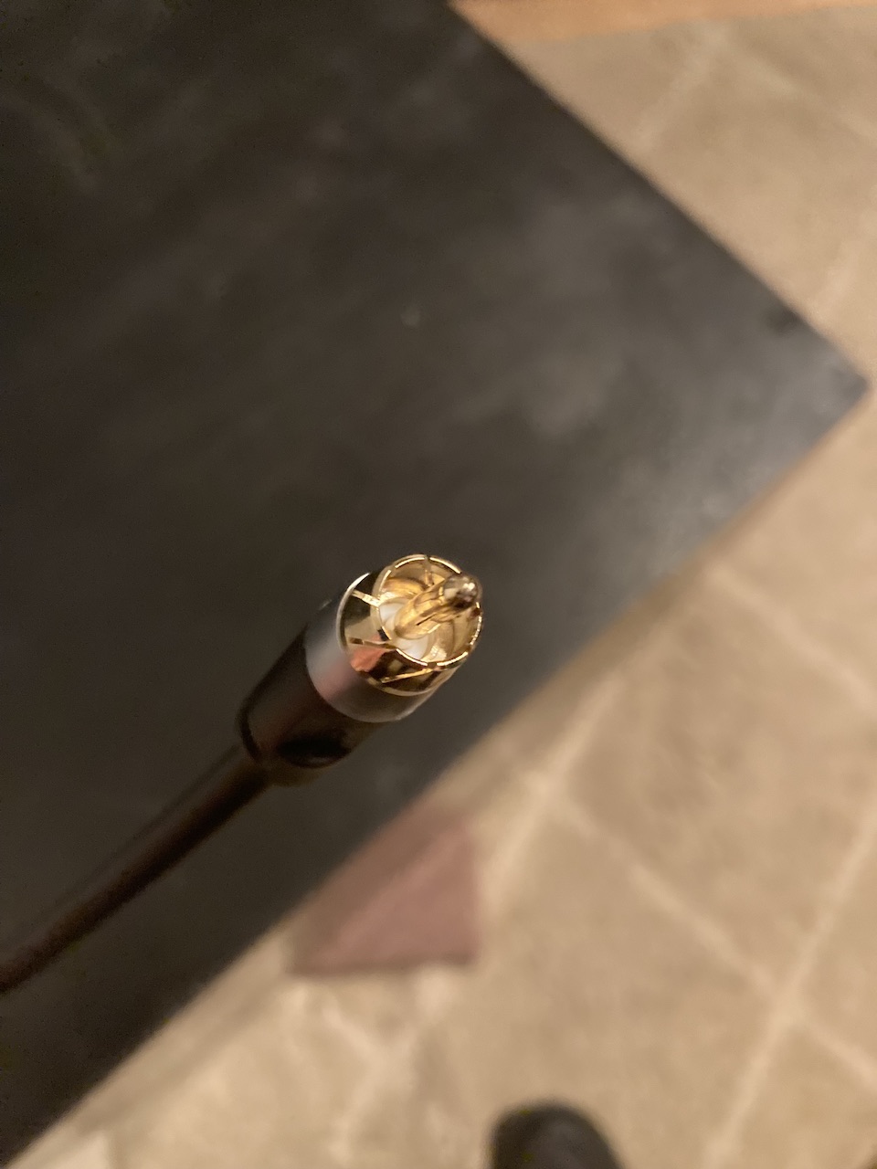

The current cable is attached to the sub with tape . Not sure if it can be rebent back or if that would break it .

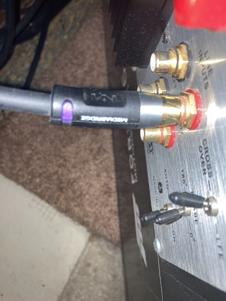

I don’t know if the top switch should be set to lfe or crossover.?

I would not try and straighten the pin. It may break off.
I think you have things correct. With the switch set to "Crossover" the sub should use the crossover FREQ control. The FREQ control is used when you have a full range signal coming in. Since you have an AVR with subwoofer management, the AVR handles the crossover point for you, so having the FREQ control turned up all the way is correct. If the FREQ control was turned down, you could potentially filter out bass below the AVR's setting.

Not sure if I got space to move the jamo, too much stuff in this room.

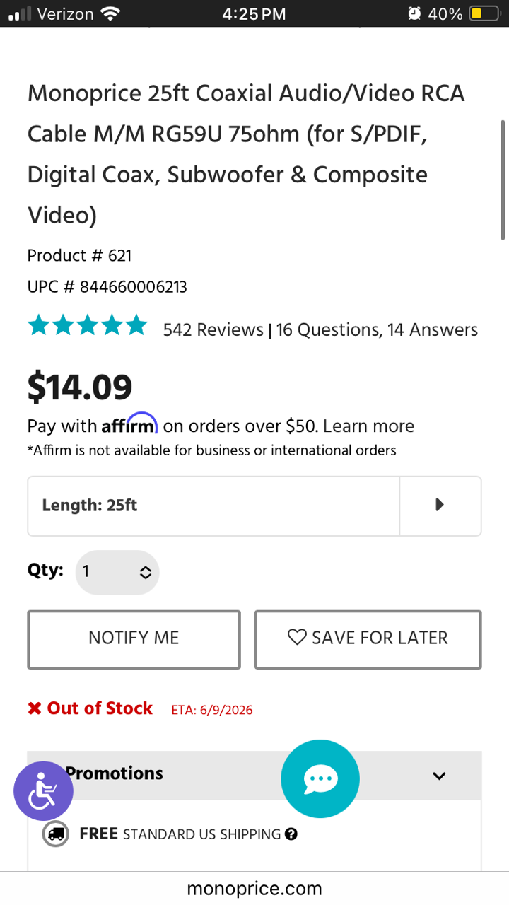

but for the diy I’m deciding between regular style like the Monoprice and a 90° Right Angle RCA Cable ??
Which is Less likely to bend like this old one did? Plus I’m going to measure to see if I need more than 20 feet . or if 15 is enough?
