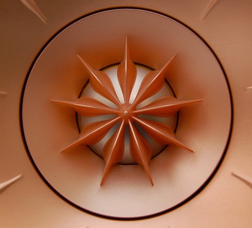

What I still don't understand is why no one calls this KEF's tweeter design "kardamom":

This is precious info. I got the thing but still have to learn how to use it. I suspect I'll need it the most when I try to blend in the sub. I will try this test you describe. Since LS50's are point source and with a wave guide, I expect some off-axis. :)
"Concentric Cardamom Driver" I like it!
