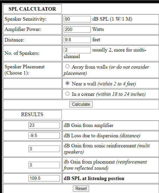

I used your suggested value of 90 dB and got these results (on the basis of the 2 fronts).
No idea what they mean though!

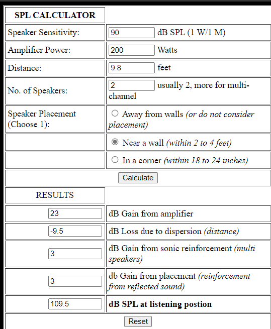

The following will help you understand what it means:
SPL Calculator: How Loud Will Your Amplifier and Speakers Go? | Home Cinema Guide (the-home-cinema-guide.com)
At your listening position, you won't get close to 105 dB, that is the so called reference level based on THX standard, until you set you volume to about 0 to +2. What's your volume setting you listen to now, with the 1910?

Yeah, I did spot that, but wasn't exactly sure what they meant initially. On reflection, it looks some of those numbers will either blow your speakers or your eardrums. Most likely both!!!
It could. But it mostly means that these $1500-$3000 AVR's can output a lot of watts into 4-ohms.
For example, the Yamaha RX-A3080 could output almost 300 Watts x 2Ch driven into 4 ohms. The Yamaha Z11 could output almost 400 Watts x 2Ch driven into 4 ohms!
Takeaway message is that many of these AVRs are extremely capable and have high quality amps in them. Yet, some people chose to use some lower-quality external amps, instead of just using the AVR's higher quality internal amps.
