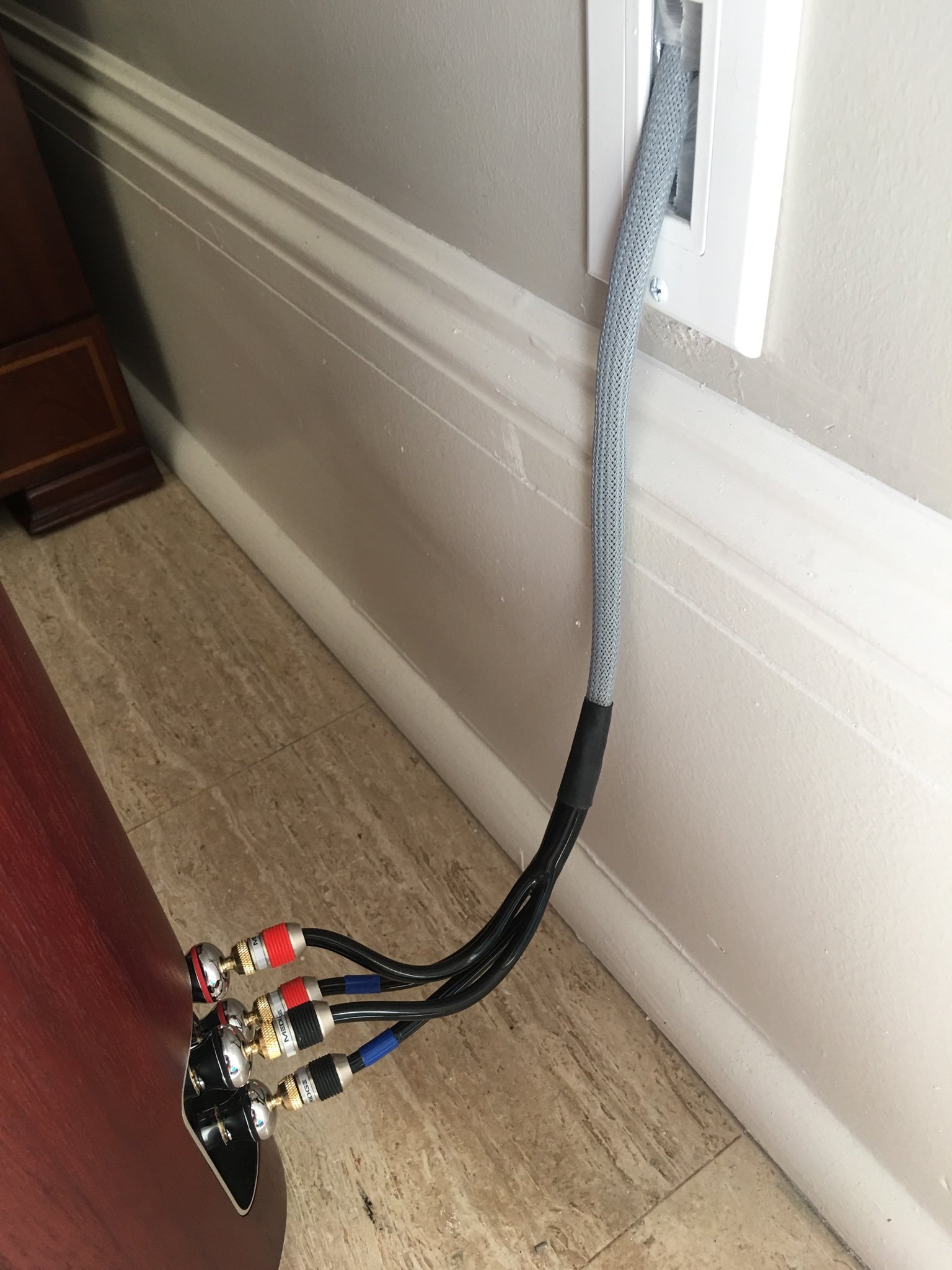

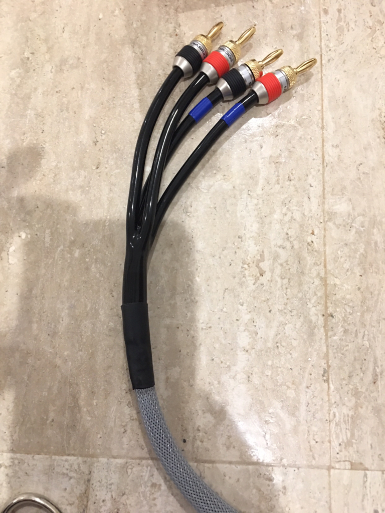

On the speaker end I added some wire pants, tech flex, and a little heatshrink which makes the cable looks very finished.

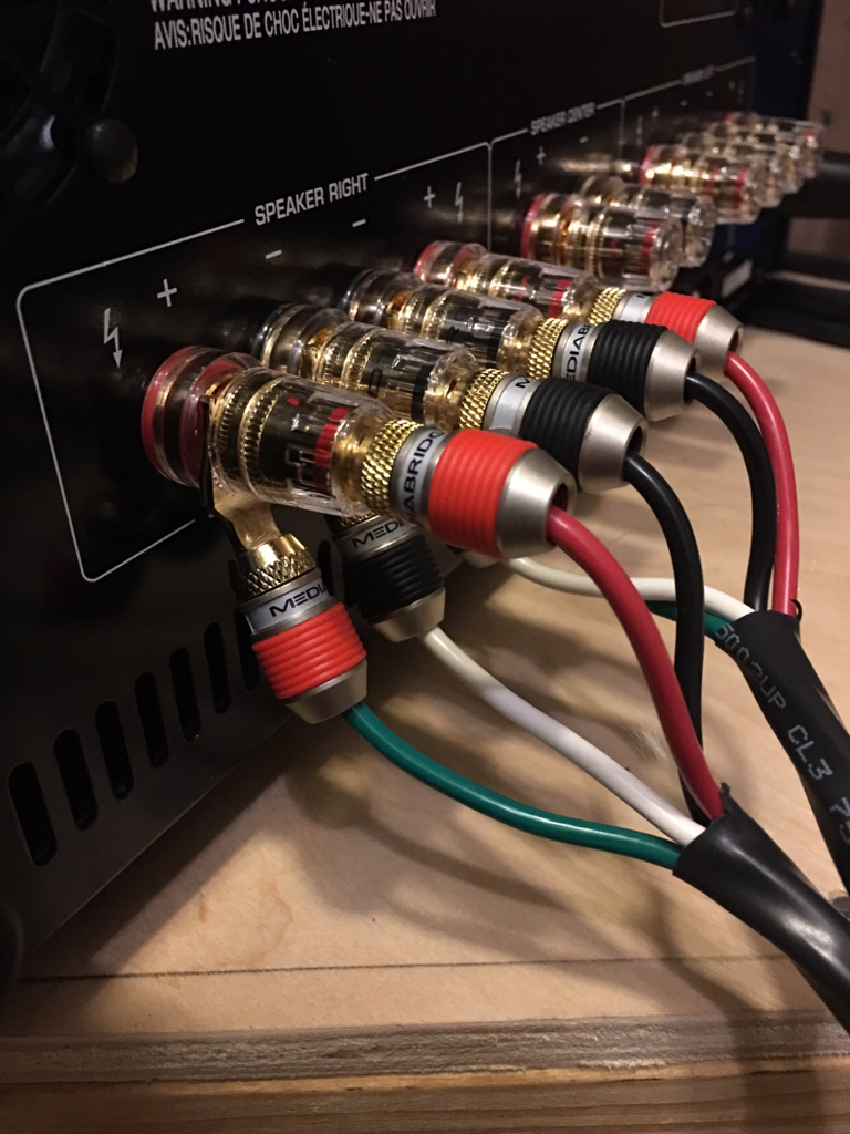

Yes. I have a 70ft run to main front speakers. I planned on joining the 4 conductors into 2 conductors to reduce the overall impedance on the long run, but B&w recommended I biwire their speakers instead. They said that their speakers are designed for biwiring. There are quite a few speaker companies that recommend this.

Oh, you have definitely joined the 4 conductors into 2 conductors, the pics on the back of the AVR make that clear!
Even if you took the connection plate off the back of the speaker terminals, it's a moot point b/c they are connected at the AVR.
