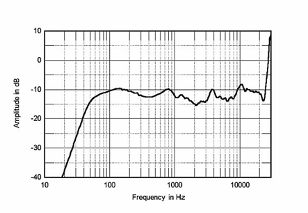

To illustrate this Kevlar resonance noise problem, I wish I could show you a frequency response curve of a 6½" Kevlar woofer with no crossover filter. B&W doesn't sell them as separate drivers, and they seem to have made efforts to keep such information from being publicized.
The only way I know to illustrate this is to show measurements published in Stereophile reviews, in this case, of the B&W CM1. The overall frequency response curve shows a dip centered around 2 kHz, and peak just below 4 kHz. My guess is that is what remains after B&W's crossover plus trap filter circuits cut down the amplitude of that offending peak. It is what causes the high frequency harshness you described.

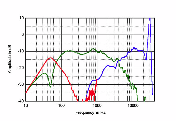

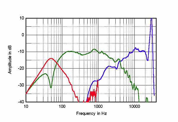

This next graph shows the responses of the mid woofer (in green) and the tweeter (in blue). This is done with the presence of the crossover plus any added EQ filters that B&W put in. The offending 4 kHz peak is mainly from the mid woofer and partially from the tweeter. My guess is the unwanted harsh noise is all from the mid woofer, but frequency response curves alone cannot directly tell you that.
When you listen to music, 4 kHz is high enough to be mostly harmonic overtones of lower frequency primary tones. If an instrument, such as a trumpet or saxophone, hits a note at 1 or 2 kHz, there will be harmonic overtone sound at double (1st harmonic overtone) or quadruple (2nd harmonic overtone) the frequency. So whether you hear the offending noise depends of the musical content and how loud you're listening. It can only be fixed by preventing the Kevlar mid-woofer from responding at roughly 4 kHz. Changing the tweeter, treating the reflecting walls, or playing with equalizers cannot treat the problem at it's source.

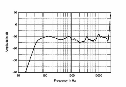

This is a graph I found online -- published by Sound and Vision -- of the CDM NT series measurements -- the bottom red line is the CDM 1 NT, which is what I am using as my fronts. It also seems to show a slight peak around 4khz, but I don't know if it is as pronounced as the graph for the CM 1 that you attached shows.
Thanks for posting that graph. I knew there was one around, but I couldn't find it on Stereophile or SoundStage.
Yes, that S&V graph shows a peak at roughly 4 kHz, about 2.5-3 dB peak above the 75 dB line. At roughly 2.5 kHz, there is a dip down to about 2.5-3 dB below that same reference line. Going from the dip to the peak is at least a 6 dB difference.
The CDM NT series speakers have an overall frequency response that I wouldn't call smooth. There are a number of peaks and dips. But that peak at 4 kHz, is not just a louder response, it's noise that you really don't want to hear. No equalization can fix that.
Swerd
Swerd
