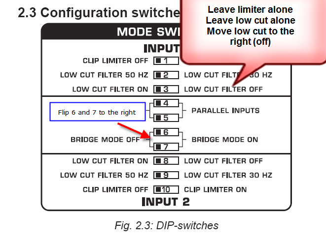

O.k. ... got it all ready to go except for the dip switches.
I can't seem to figure out which ones to move.
Running one channel to a dual 8ohm Tempest-X??

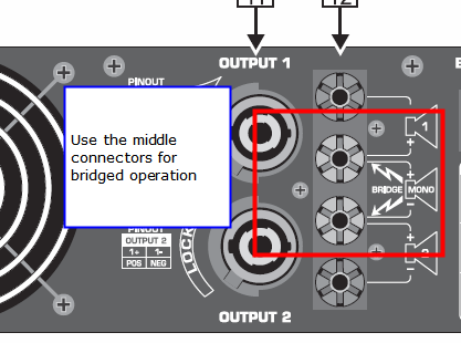

*Also, how do I wire it from amp to binding post '&' how do I wire it from post inside to sub?

First off if you are running the amp mono blocked you only need to mess with the two top sets of switches.
E
E-A-G-L-E-S
Wow!
Thanks!
One question though...am I actually running the one channel bridged or just normal mode on one channel?
That picture make sme think I'd be using the whole amps total power, which is way too much for the single Tempest-X....but I very well could be misunderstanding. :)

Wow!
Thanks!
Bridged means a doubling (roughly) of the power. You could drive the tempest with just one channel, or keep it bridged and set your amp gain nob at the middle mark and keep it there.

Well, since I will be getting a second one not far down the road I'd like to just run one channel so that I wont have to disconnect it then.
So how should I set it up differently from your pics?(which are great by the way)
And wiring how to the sub from the binding post on the back panel?
Just look at the diagram on the back of the amp. Move 6/7 dips back to the left. On channels one and two keep the cut off turned off.
On the binding post the top two to the right channel and bottom two to the left. But since this is a single sub right now it doesn't matter.
