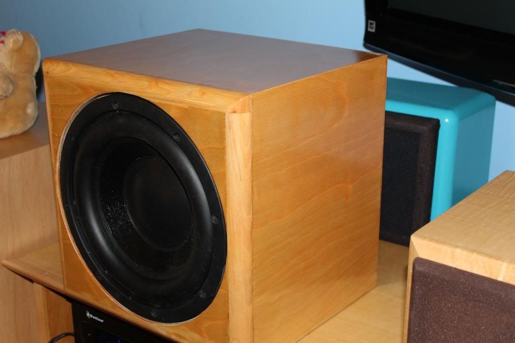

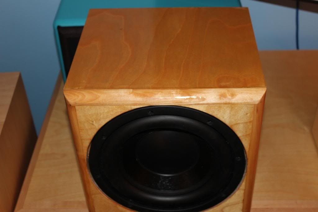

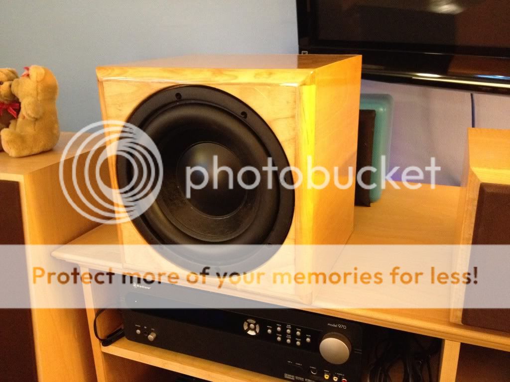

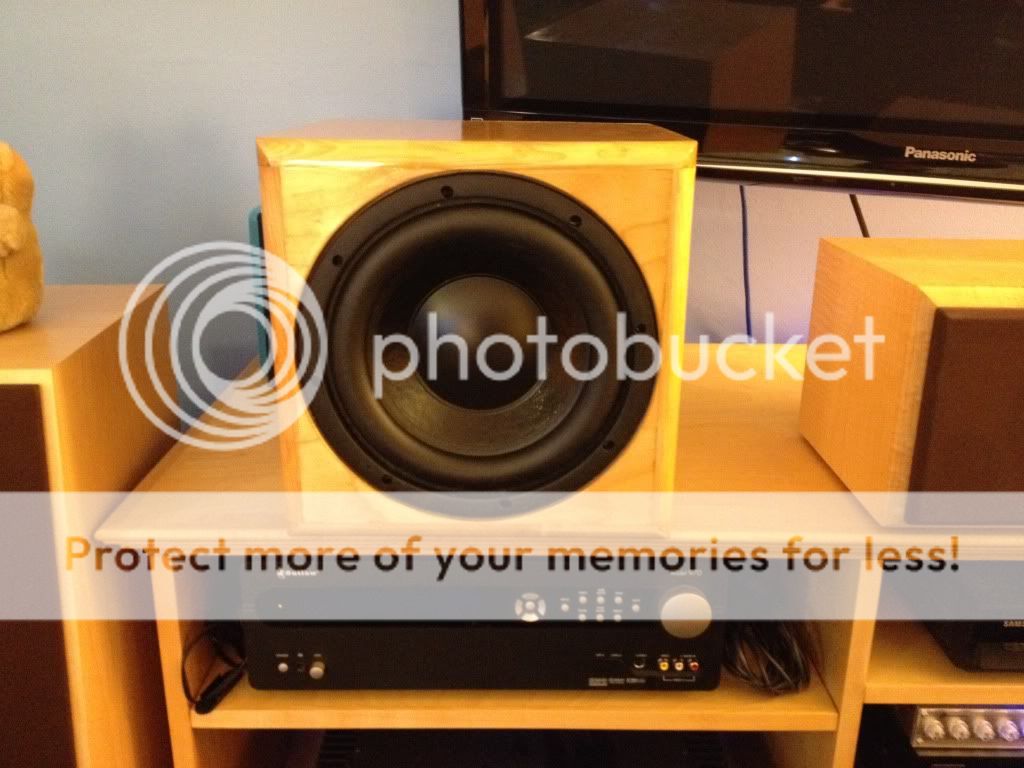

I have no doubt Dr. Marks would be better for the JL driver performance wise, and you're right, it's double the size and ported is always a bit more complex.
I don't remember exactly what Vb was/is, but it's less than a cubic foot even before the driver is in. In terms of xmax, it'll take 800+ watts before it reaches xmax in this box, but in terms of thermal power handling and distortion, it would probably max out at 4-600 watts. Kind of a large range, but I haven't really pushed it so I'm not sure. I'll have to do a bit more testing when I'm done with the finishing.

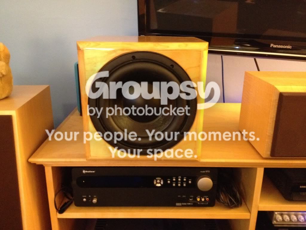

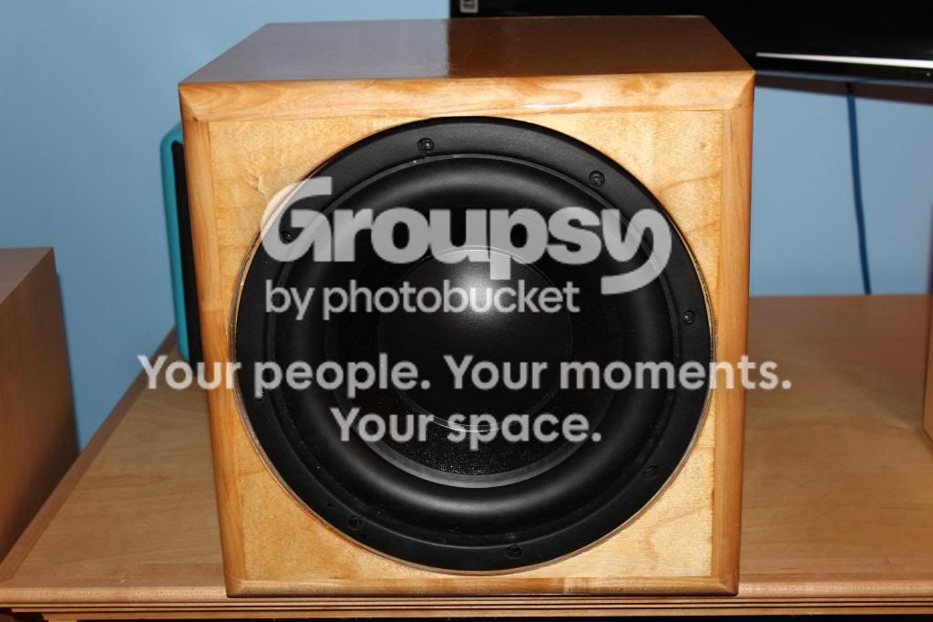

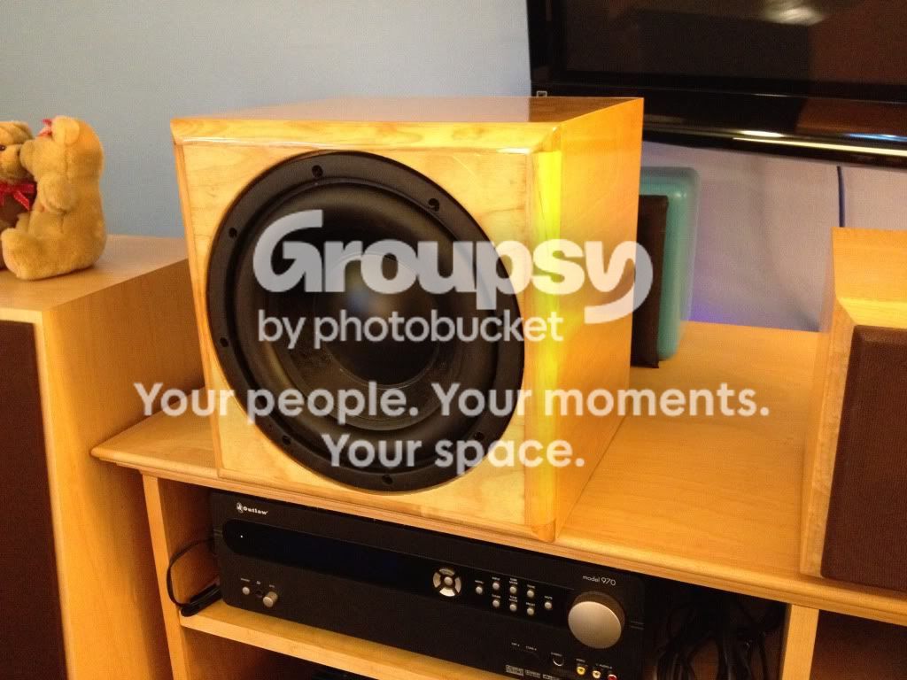

Finish it up already so I can go pick her up!:p
Oh SH!T!:eek: I need that sub for my Desktop setup. Dang looks great!
