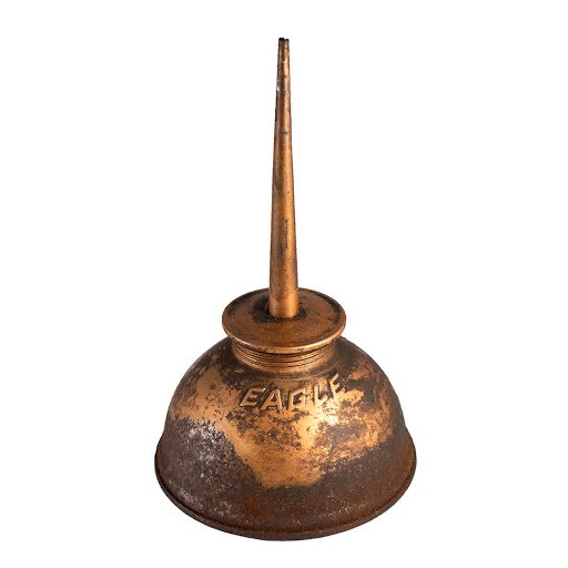

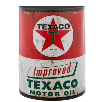

A little more seriously, I think an 'oil can resonance' occurs when the tweeter dome moves out of phase with the movement of its surround - in other words, the surround is moving the tweeter outward but the center of the tweeter is actually moving inward. This is all related to the frequency, the mass of the dome, inertia, and a bunch of other physics terms I can't remember.

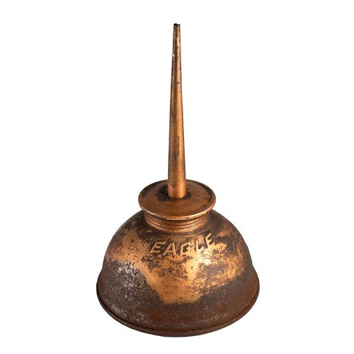

I think - I'm guessing - that the terminology comes from the old style of oil cans somehow?
LOL don't keep track of oil can style much....mine come in plastic bottles these days.

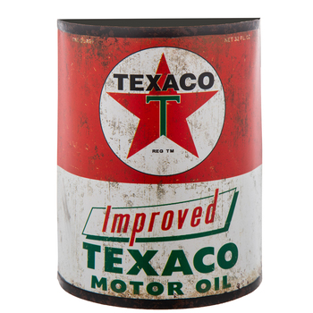

I am probably incorrect about this, but the first thing I thought of when I read Gene's post was that he was referring to 'steel drums', like the one's used in Trinidad and Tobago.
Wouldn't that be more an oil drum resonance? :)

I think he means the type of oil can that has a skinny spout and when it's used, the neck of the can is held between the index and middle fingers with the thumb pushing on the bottom, which makes a kind of sound that's similar to "pooka", when the bottom flexes in and returns to its original shape by itself (usually because of a spring)- it's naturally convex, but pressing it in makes it concave and that pushes the oil out.
The tweeter dome is pushed at the edge, but when it can't remain in its original shape, it distorts, causing problems with the sound, with the center of the dome approximating the action of the bottom of an oil can when pressed.
