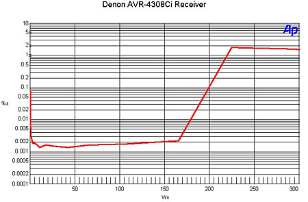

That is a good point, but in many cases, both Gene's and S&V's test do show distortion numbers at very low output level.
Below are two examples:
Note that it says "The distortion level remained at or below 0.002% across all power levels until it reached about 165 watts."
Read more at https://www.soundandvision.com/content/denon-avr-4308ci-av-receiver-measurements#tZGKX051SIrqwsbb.99
https://www.audioholics.com/av-receiver-reviews/denon-avr-x3300w-1/measurements
That was just one example. If you hear something, and measurements don't reveal it, you need to explore further measurements. Static (single frequency, whether at a fixed value (1 KHz, the easiest frequency for any audio device to drive) or swept (eg 20 to 20KHz) distortion measurements combining all harmonics is of very limited value. It will only reveal the grossest of aberations. In other words simply verifying you have a very poor Device Under Test (DUT). A Intermodulation Distortion test is far more illustrative, but then again the two standard test measurements for IMD are only two static frequencies. Real music contains much more (by orders of magnitude) Intermodulation opportunities, but is far too complex to set out a measurement regimen.
The Audio Precision test instrument has a more complex IMD function available, still far from real music in complexity, but Gene does not posses one. The image you cited from Sound & Vision may have been taken from an AP or not. Faking an AP readout is common, unfortunately. But it does not look like a genuine AP test printout (see example) so at a minimum it's been massaged by the Graphics Department.
But regardless, it's not simply about distortion. There are other areas that may cause sonic issues; the point being that if you don't test for it, you won't see it, and choosing the test that reveals an audible issue is rarely done by reviewers for the reasons I cited in my post (cost, desire to limit tests to a standard suite so readers can make basic comparisons with other gear, etc).
