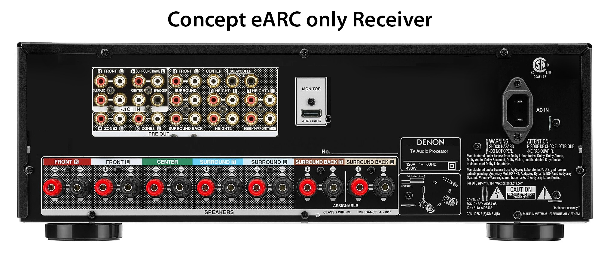

Hi! Well I'm recent to the AV Receiver world, and one thing bothers me. Why is that all receivers are video processors as well? Aren't we just adding another variable to the mix (source + Receiver + TV)? After finding the perfect TV that supports everything you want (Dolby Vision, 8k, HDR10+, VRR, G-SYNC, etc) you still have to go to the trouble of finding a compatible receiver with all the features you want? TV's are perfect HDMI switchers and there's ppl that only stream Netlflix and alikes from the TV OS anyway.
Is there any brand that makes a receiver with just on HDMI eARC port? Let the TV do the video processing, and let the receiver do the Audio processing and cut a few bucks on the price of the receiver by removing all the video ports and capabilities.
I'm not saying that there shouldn't be AV powerhouse receivers with Video and Audio processing for the folks who want that, but what about a simpler solution?
Am I missing something?

Well you can add some audio only inputs as well (toslink, Phono, etc)
LOL tvs are far from perfect hdmi switching devices. Audio Video Receivers do combine audio and video but few of us I think use the video processor except to upscale old legacy video stuff, many tvs will be the superior processor. You could get just an audio receiver, but they tend to only be 2ch.....

That receiver would be fine if every app, device and TV supported all of the same codecs so that you could send the best signal out to that receiver. You would also need a TV that had 6 or 7 HDMI inputs, not just three or four. I've not heard of anybody who thinks that their TV's built in apps were better than the ones in their favorite streaming device.

OK, I shouldn't have said "perfect" since I don't have enough experience with AV Receivers. IMHO TVs do the job. But do you get my point? Licensing and testing VRR, GSYNC, Dolby Vision, 8K processing, etc must add to the cost of the receiver.

What I am proposing is what soundbars are already doing. A simple plug and play experience for the folks who don't want to go all in, but want a discreet 5.1 or more system. I guess you have to make sure that the TV supports all the features that you want, and I think LGs 2019 models do, and that you only need 3 HDMI devices (e.g. Game Console + BR player + streaming device) since one of them is eARC.

I agree 100%. I want a minimalist earc audio processor, no video and found this thread while Googling for it. I want to plug a few devices to the HDMI 2.1 TV, have the TV be my center channel and send decent audio to whatever speakers I have installed. The video switching is always the weak link.
