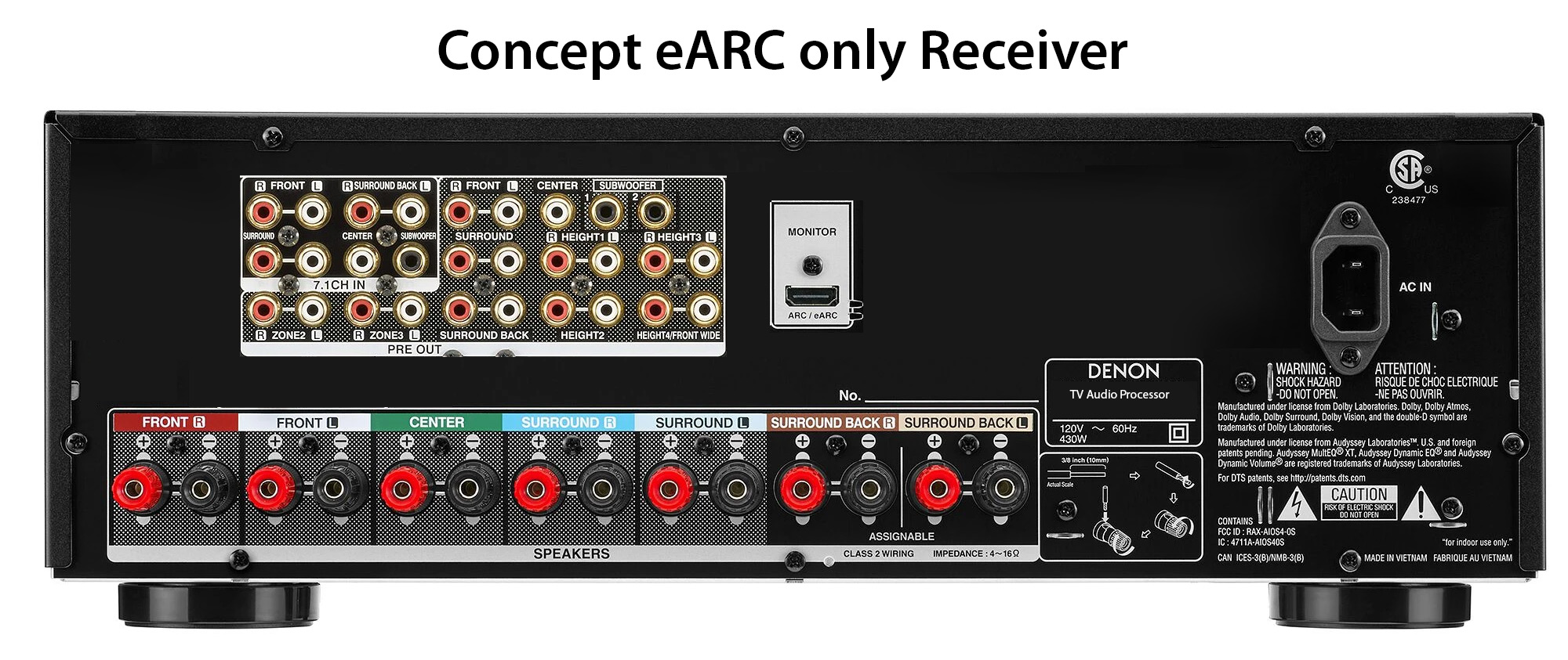

Hi! Well I'm recent to the AV Receiver world, and one thing bothers me. Why is that all receivers are video processors as well? Aren't we just adding another variable to the mix (source + Receiver + TV)? After finding the perfect TV that supports everything you want (Dolby Vision, 8k, HDR10+, VRR, G-SYNC, etc) you still have to go to the trouble of finding a compatible receiver with all the features you want? TV's are perfect HDMI switchers and there's ppl that only stream Netlflix and alikes from the TV OS anyway.
Is there any brand that makes a receiver with just on HDMI eARC port? Let the TV do the video processing, and let the receiver do the Audio processing and cut a few bucks on the price of the receiver by removing all the video ports and capabilities.
I'm not saying that there shouldn't be AV powerhouse receivers with Video and Audio processing for the folks who want that, but what about a simpler solution?
Am I missing something?
Last week I got a new LG 2021 television with their latest webOS 6, and for the first time I liked a TV's built-in streaming apps, video source switching, and remote, better than my Harmony remote, Roku, and using my AV receiver as a hub.
But my 2010 Denon receiver will only process PCM over ARC. So I went looking for a simple eARC receiver last week and found this post. But as you note, they all include expensive video processing that make them cost $1,000+.
When I did some further searching today, I found this was just released this week...
In case my new account doesn't let me post links, it is a $228 HDMI processor called Sharc from Thenaudio, which takes the eARC signal and passes CEC and the full HDMI audio stream to any HDMI enabled receiver, so I think that it would work as the concept receiver you are thinking of when combined with an older AV receiver that is not eARC compliant, but which can process the surround sound format you want. E.g. I'm thinking of using it with a 7 or 9 channel receiver that can do Atmos.
Trebdp83
A poster found success using that device in another thread. It should get you lossless audio but will come over without atmos metadata in your case if connected to the older Denon.

Thanks for this post! And yes, in my case I am considering buying a used 9 ch AVR to go with it since that would still be much less than a new eARC compatible model.
