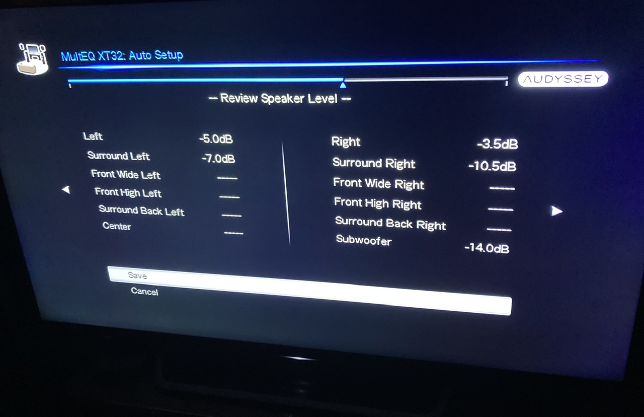

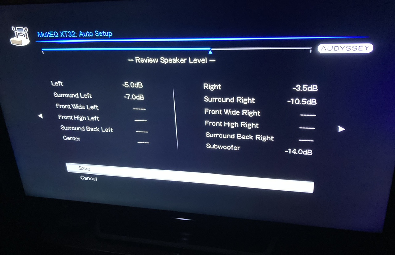

mine kept doing that also this was the best I could get . I don’t understand why avrs do this.
What model avr do you have that allows -14 trim levels? Can it go to -15? The Audyssey avrs are +/- 12 trim levels that I've seen. As said earlier in the thread, its in relation to the gain level you have set on the sub/sub amp. If you can go to-15 on the avr trim level, then -14 is fine. If that's the limit then try turning the gain on the sub/sub amp down to get a higher number.
