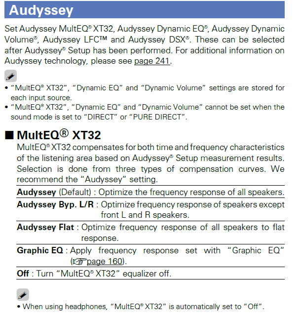

But, how do I know if it is set to "Flat" or not? The 530's sounded very bright so I lowered the levels just a bit. That helped a lot. Thought that by taking the coffee table out of my room with all of that candy may have been a reason, no?

Download the manual and turn to page 156.:D To save you time, I took a snapshot for you.
Your table with the candy mountain most likely would have affected the tonal balance. Since you've moved them out and re-ran Audyssey already, you should be fine now. Audyssey is actually the default selection. You can also try Byp.L/R to see if you like it better. If the 530 remains bright then I guess they are, at least in your room. Instead of lowering their level, it is better to increase the sub level otherwise you will upset the balance between the center and the surrounds.
