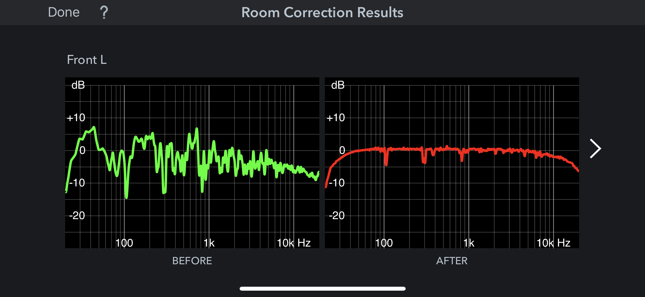

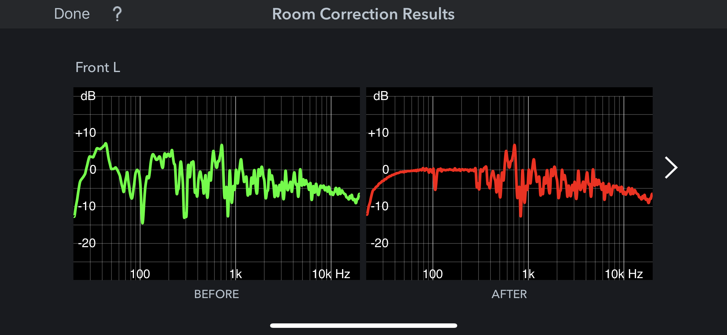

Hey everyone. Playing around with the Audyssey app and different speaker positions. I read that the app was great since you’re able to set the filter wherever you want, and room EQ over 250-300hz isn’t necessarily a good thing. This is my front L speaker with the filter set at 20khz (top) and set at 500hz (bottom).
Now obviously I’ve got more work to do with placement given that massive dip at 100hz. But setting the filter down to 500hz makes it look as though I’m losing another 2-3 dB at each dip under 500hz. Not sure why that would be?
Also just looking at the comparison from the top, *relatively* flat result when EQing up to 20k would be considered worse than the bottom set at 500.
I ran Audyssey a couple times yesterday with a couple different front placements and it’s interesting to see how it affects BOTH before and after results. But also a huge pain to have to run Audyssey each time (although I just run 3x with the mic at the listening position vs moving it around). So I’mplanning to download room eq and get a mic. So the other question would be, if I can find and address problems using that software if there is a way to apply the software findings to the receiver?
A lot of questions I know. Just head over heels with my new hobby and curious as hell to figure everything out!

You should use at least 6 positions ideally 8 if your not against a back wall. The different positions are only a max of 2 ft from the starting Lp. The more positions the better the average. I use a tape measure be sure all measurements are a minimum of 20 inches from a back wall. measure the MLp then MLp measure 2 ft right, Mlp measure 2ft left, Mlp measure 2ft forward. MLp 2ft right forwards at a 45 deg angle, MLp 2ft left forwards at a 45 deg angle. You can go shorter than 2 ft. 2 feet is the max. This will render more accurate results

Well away from the back wall but, I’d done that in the past with 6 positions. It without fail has ended in awful sounding, hummy/buzzy bass. A rep had told me to try the mlpx3 and that solved that.

I always do all 8 measurements. The more info Audyssey has the better the correction can be. Like Zoltan said, take great care when measuring that you follow the pattern tightly and your mic is at ear level.
The "after' graph in the 2nd pic looks rough to me. I'd listen to both and see which sounds better to me. I actually prefer the adjustments made to my upper frequencies.

The before graph isn't a horrible representation, I don't think, but the after graph is not "what is," rather just the ideal.
Agree that REW, as a measurement system will allow you to see all the "what is" in better detail, before and after.
You do have some pretty significant FR variation occurring above your Schroeder Frequency. So much so that you can't really see where that point is in your room. The FR should start to smooth out somewhere above 200-300Hz which is the usual spot for the Schroeder Frequency. My instinct is that you may have a very lively room with a lot of hard-reflective surfaces.
What can you tell us about your room and positioning? Photos might help, too.
