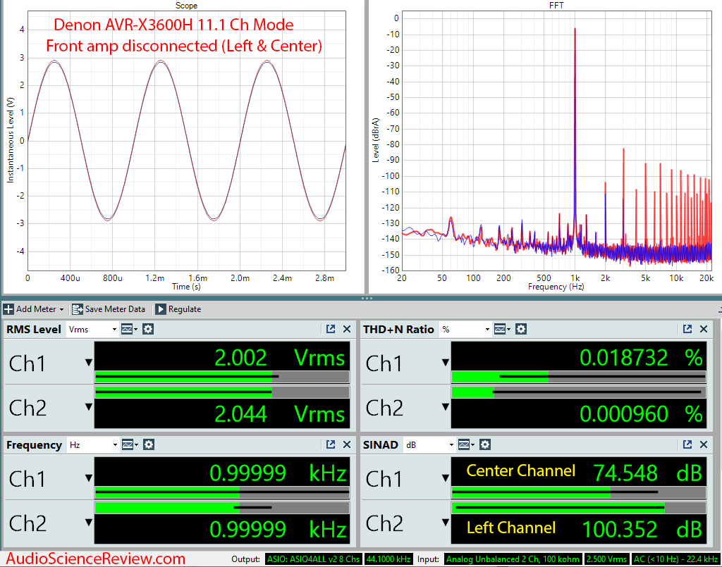

Center channel testing is needed to make an informed decision since this represents 80% of the sound. Also, not testing is performance with processing engaged.
Did you mean center channel of an AVR? He did measure it, when I requested it:D on the AVR-X3600H.
It was much worse because you can't disconnect the center channel power amp on the X3600H, but obviously you can do it on your X3700H so you can expect high 90's to 100 dB SINAD for the center channel as well. Denon and Marantz AVRs standardize the audio signal path from input to pre out. Yamaha and Anthem in their top models use lower spec DACs for the surround/height channels.
Denon AVR-X3600H AV Receiver Review | Page 14 | Audio Science Review (ASR) Forum
Clear evidence that the center channel output MUST be measured. It sucked last time :p

He actually did measure the center channel SINAD (dac/preout) once and 5,7? channel a couple times. I have the impression that anything outside his comfort zone limited by the AP model he owns, and time available, he would focus on measuring as much as possible on the front two channels, perhaps thinking that it is only necessary to measure the other channels once or twice, thinking that the results relative to that of the two front channels would be repeatable. I am only guessing, but seem reasonable to me.

That's not fair, okay I agree with you it sucked, but that's not apples to apples. It measured the same as the front right and left channels under the default condition when the internal amps are not disconnected with the amp assign trick. It also measured as good/or as bad by you standard:p as the AV7705 that has no internal amps to disconnect !!!!!
