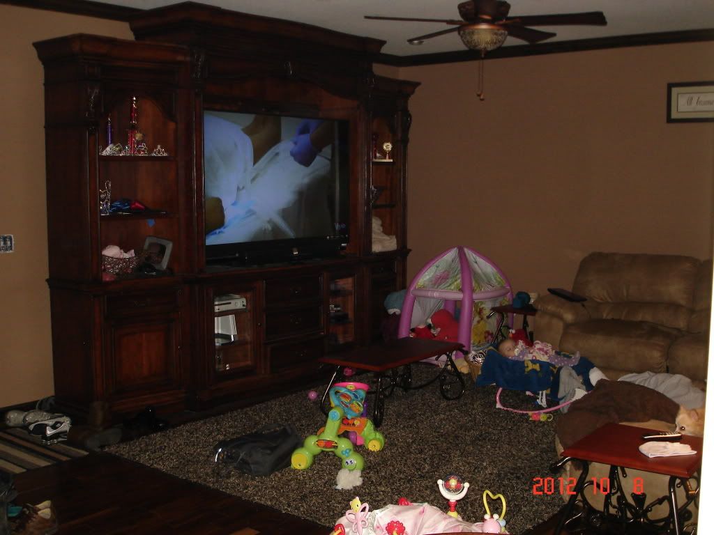

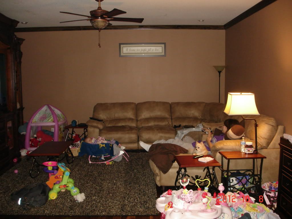

Ok thats the room pretend all the baby stuff is gone lol as her room is finished and we are working on getting her stuff in there. The couch is about 10 inches from the back wall and there is almost 3 feet to the right of the Entertainment Unit and 5 feet and a door to the left, with the couch to your back the right wall is solid and no windows and the left wall well there is none but the front left has a kickout of 6 feet also from the corner to my seat is 4 feet or so and I could do the same on the left or further if its better. I had plans on the center channel going dead center eye level in front of the tv there is room for a soundbar and a kinect there now. I am gonna hold off till the end of the week to get anything so I can take what is told to me here and educate myself further with what time I can. Can you get the surround sound effect from a 3.1? Also I noticed in the link that was posted above in reference to speaker placement that they were firing almost directly toward your ear and on the same plane as your head?

You can make it work. Surrounds can be wall mounted [though decent brackets aren't super cheap]. You will have a little trouble with the right speaker if you put it beside the entertainment center (which is very nice looking i might add). It'll be a little to close to the wall (will have some issues with reflections off the wall) and the couch will get in the way a little. The effects shouldn't be that bad.

Now I see what you are talking about, there are some real placement pros on here so they will figure that out easily..
If it were me...
I would set it up normally, heres what I figure when you are watching tv you will be sitting in front of it...
I would put the 2 towers in the front on the left and right of the entertainment-center, a sub behind them on the sides of the center, the center in the middle {in cabinet above tv with the face a little closer to you than the tv}, the first surround on the wall a couple feet over the seating area and the other surround on a stand to the left of the couch facing the other surround... It will sound good... Ive seen worse that worked...

Ok that sounds simple which way do you fire the one on the right facing the couch? I assume the r will be firing foward and the L toward the R? Also would you guys think a sub would work good in the corner behind the couch, there is a nice little void where the lamp is? Last of all all the receivers say they have a setup that helps with all this what exactly does it do tell you to move the speaker or put like a delay in place or something to that nature?
I probably wouldn't put a sub in that corner, but it could work? Receiver autosetup will automatically set the sound level for each speaker so that it is even at the listening position and set delays so that each speaker plays at the proper time for said position. They also set some equalization curves specifically for your speakers, some receivers do a better job than others and some people just don't like this at all. Overall I've found this equalization to be extremely hit and miss, but the distancing and delaying usually works well enough.
angle them slightly towards each other with the center couch seat in the middle of them, this will be just moving them around and feeling it out, but your room isnt that bad..
My bedrrom was tough, because the bed is in the center and the tv is on left of the bed, so the center and left right are there but when you mount the surrounds one had to be above the bed and one on the opposite side of the room, Itryed it that way first and I was surprised it worked, so I tryed 4 or 5 other places and went back to my first instinct... works good...
