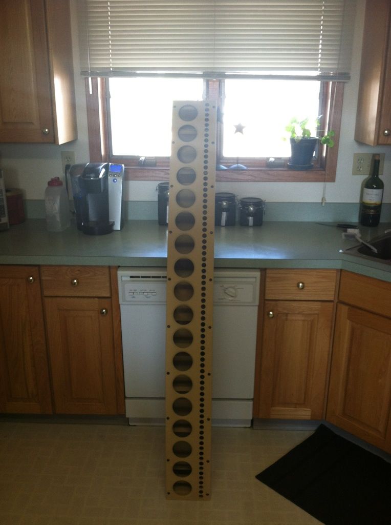

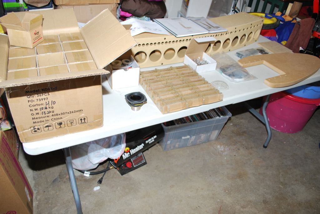

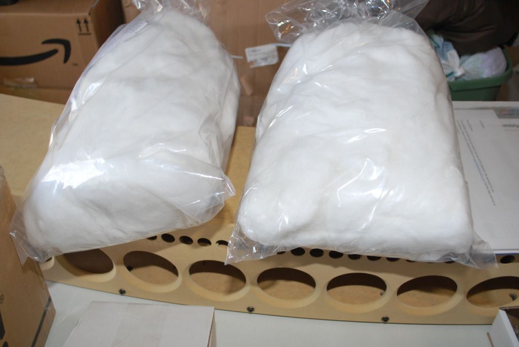

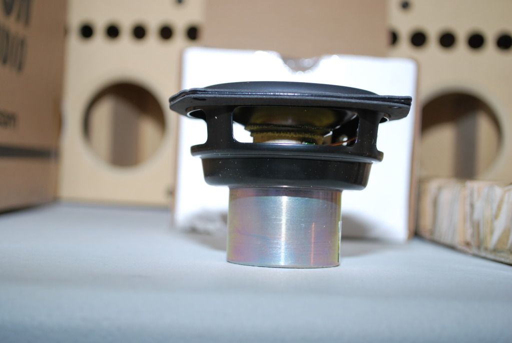

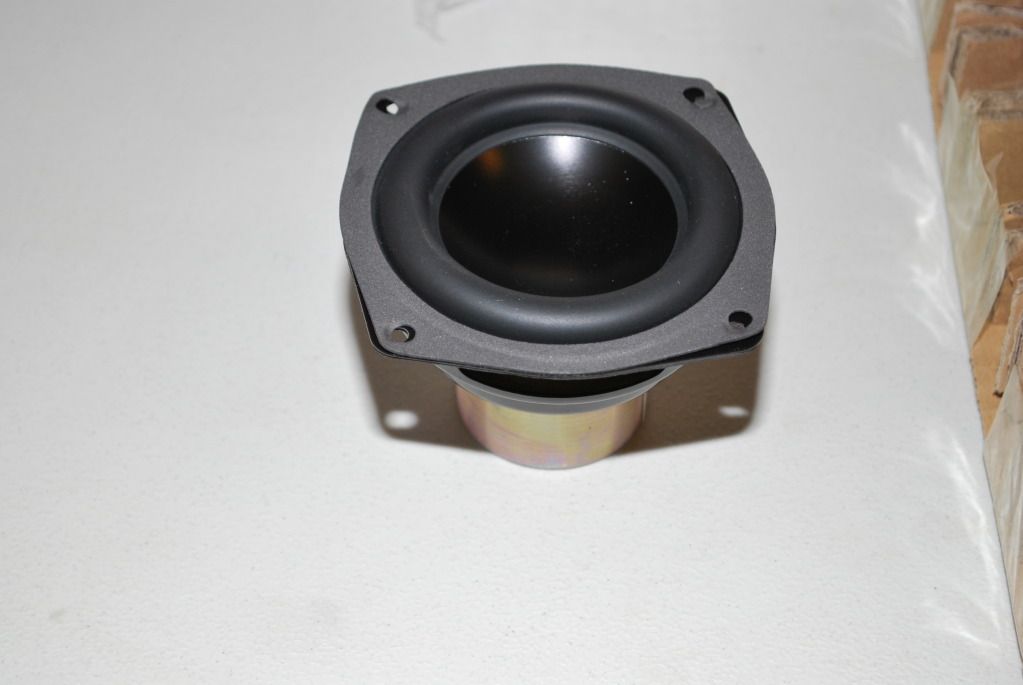

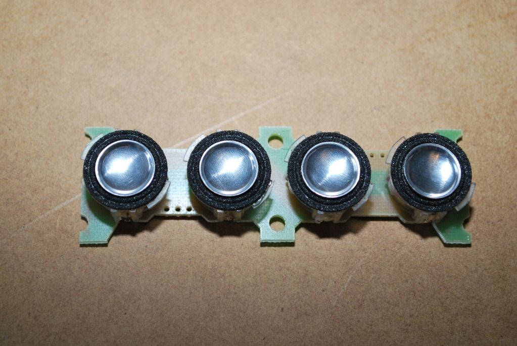

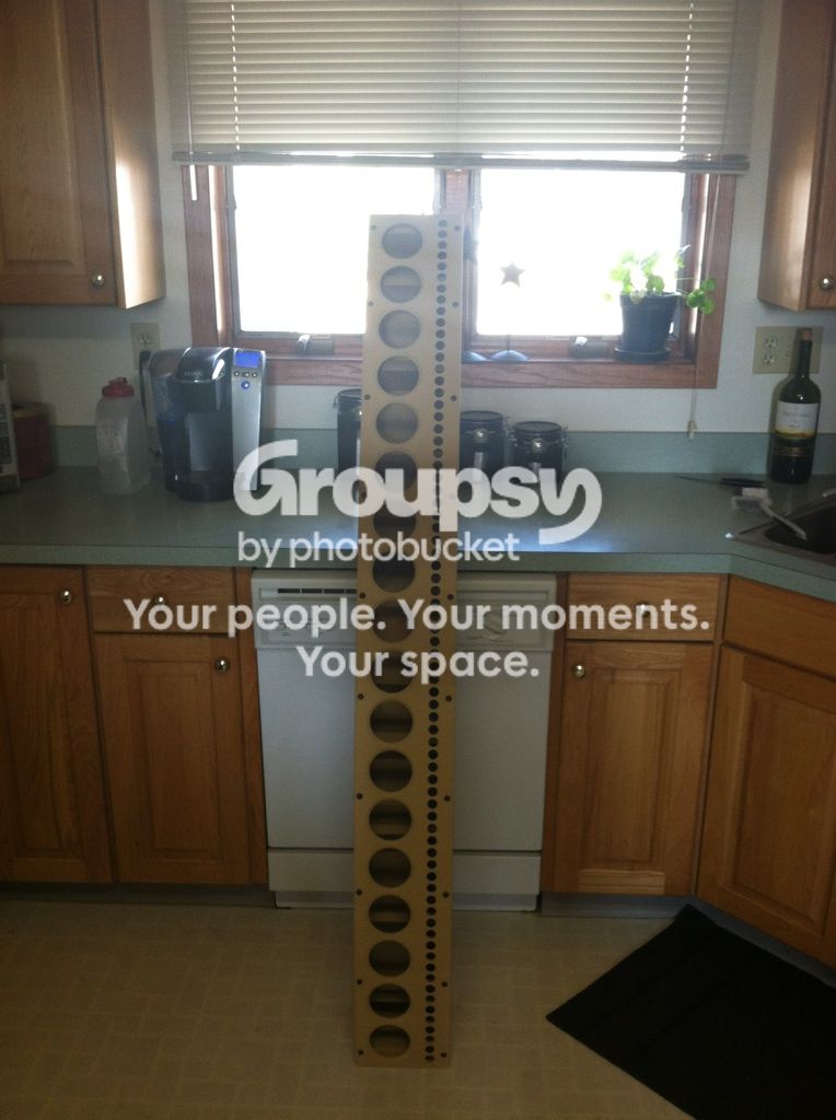

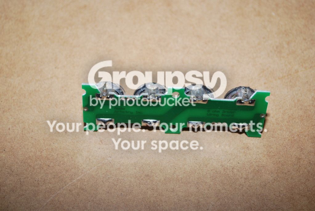

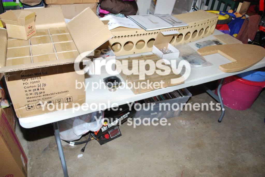

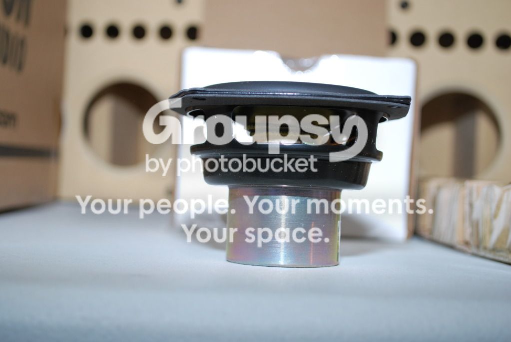

Well after deciding I wanted to do a HT in the new house, I had to decide on some equipment. I decided the best thing was to find a forum and listen to the experts(end users). With the recommendation of GranteedEV I decided on the CBT36K kit. Here is the kit to save you a google search.
CBT36 Line Array Speaker Kit Pair 301-980
I will post some progress pics as I go along but here are a couple to get you started.

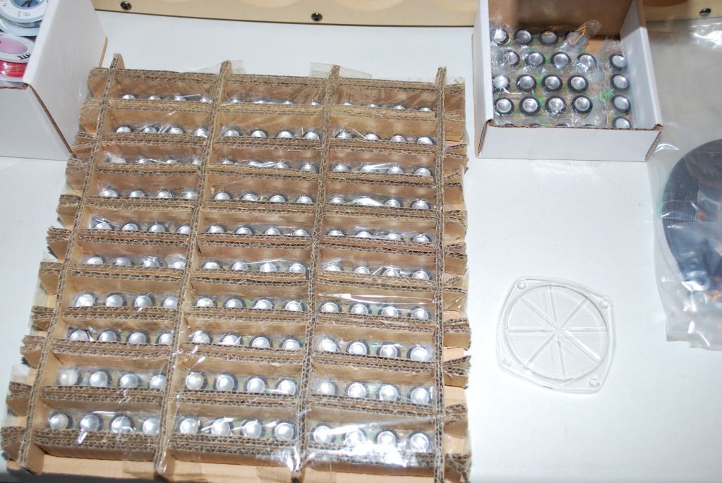

Since there are so many drivers, I would recommend that you test them individually before mounting.
The simple AA battery test (momentarily connecting the battery across the terminals sound cause the cone to move). Rince-repeat x 180.

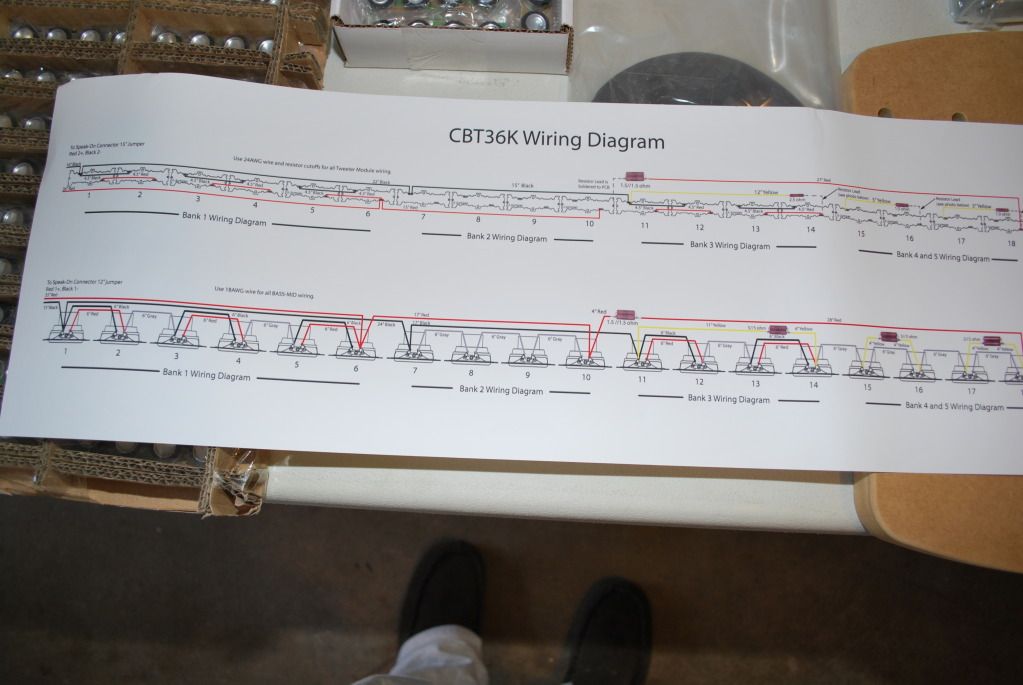

The CBT36 assembly manual gives a step by step for setting up the DCX2496. That alone may justify the extra price for some.
Page 81 of the manual gives a tabulated list of filters applied. It should be fairly straightforward to recreate the overall crossover and eq. Operative being, should. No comment on whether it will sound same or not.
