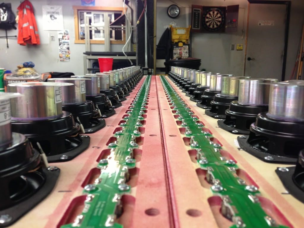

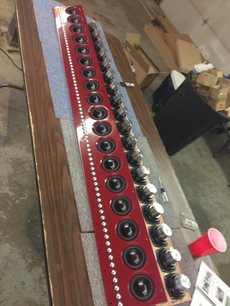

I am just now getting the painting close to being done now. But I have been going through the manual and it doesnt seem to hard. I initially thought I would have to solder each tweeter to the driver, but they came attached already. That made it a ton easier.

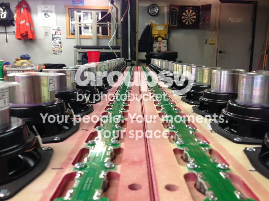

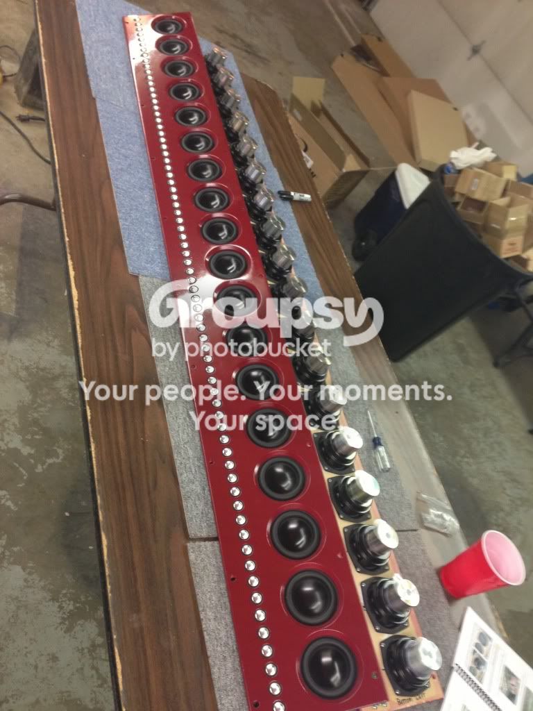

Ok, so its been a while but I finally found some time to get this along. We will be done un under two weeks but here is some progress.
